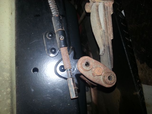

This might help......
All the Best, Chip
"It's wise to choose a SIX"
There should be two holes in the frame near the mount for the front spring shackle. See photo below.

Does the bolt tighten the bracket like a clamp? There is an indent on the retainer. Does it fit into an indent on the cable?
1932 Chev 5 Window Coupe
Yes, Yes, The through bolt retains the cable end by slipping into the depression or indent. When tightened it also clamps the cable end. Hope you find the two mounting holes on each frame rail.

Found the mounting holes. Now just need to find the retaining brackets, (or make them).

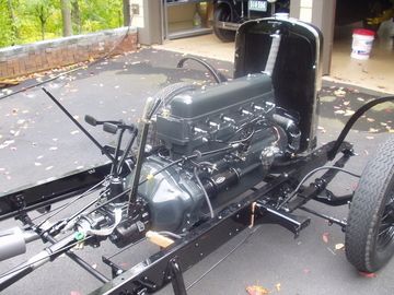

Hi Chip
That's a great picture of your engine. Just a quick question about the color grey. Asked around and ordered paint from the Filling Station, and it is a lot darker than what I see in your picture. How did you decide on the color, and where did you get the paint? Is there a color code? Thanks.
That Looks to be the picture and light
most everyone uses the Engine Gray from TFS (The Filling Station) depending on the light it looks different. Some of my pictures it looks DARK, others pretty mellow.
A lot of work was done many years ago to verify and reproduce the correct dark-blue gray engine paint. New OEM parts, paint out of Chevrolet cans etc. were compared. Several people participated in the evaluation and documentation. The conclusion was the claimed and most readily available medium gray engine paint was NOT the correct color. It was understood that at that time the vast majority of recently painted engines were not the correct color. That was going to irritate many folks and create controversy. Nevertheless identifying the correct color and making it available was more important. There are still plenty of engines painted the medium gray and people who will argue that their engines are painted the correct color. I even have a few painted the wrong color that I have not changed.
The correct color has been available from the Filling Station for many years.
