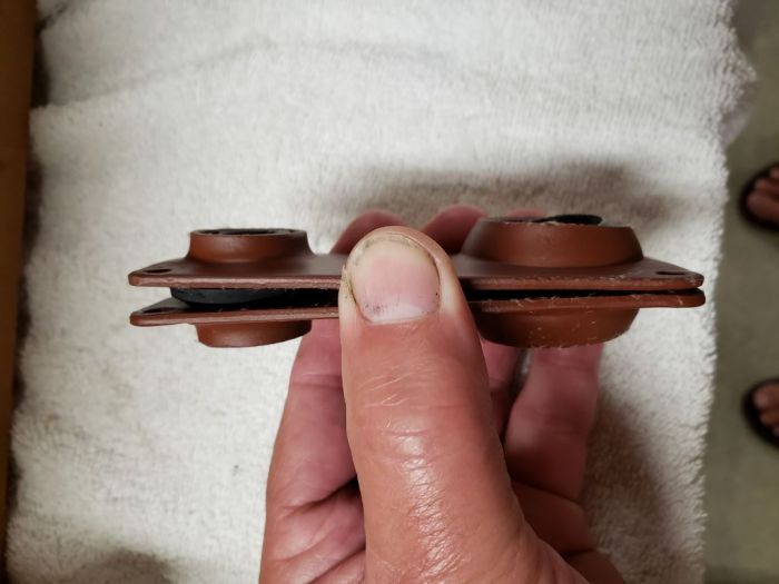

Sorry to come in so late on this thread, but I ordered the rubber bearings (for the frame connection point) for the supports from TFS. It seems that they are somewhat thicker than they need to be. When put together, there is about a 1/4 inch gap between the two halves. Has anyone else had this issue? Should I just trim them up to fit better? Also, I assume the metal sleeve that was in the original rubber bearing should be put back into the new ones so that the nut can seat against it? Thanks.

What is the part number of the part your are referring to. There needs to be room for the lever end of the bracket to move . The inner sleeve is held tight to the frame and the rubber bushing (one piece part) between the sleeve and the lever allows that movement.

I have attached photos so it may be clearer. You can see how much larger the new bushing is and how the two halves of the bracket fit together with the new bushing and the old worn bushing. Also have pic of the bag. I got these new bushings some years ago, and just did a search in TFS and can't find them now. I think I can trim the new bushing down to fit. Not sure the old steel sleeve/spacer will fit in the new bushing or not.

I think that the reproduction bushings have been discontinued.
Trimming slightly may help. When I installed mine I did not take the bracket apart. I installed the inner sleeve and then compressed the bushing with a hose clamp - centered the assembly over the bracket and pressed it in. That was a long time ago and I think I pressed it in using my vise. Be sure to lubricate the bracket and bushing. The bushing needs to have compression tension on it when installed to function properly.
