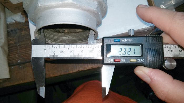

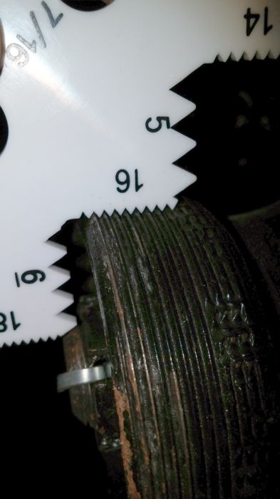

can someone validate the thread diameter and thread per inch for the 1929 hub cap and mating thread.
unfortunately my thread gauge will not FIT in the area to measure it. looks to be approx 2-3/8" diameter. my thread gauge is the L-type worked great till now and it is too big @!
gonna have to order another thread pitch gauge (smaller compact style)
any easy way to chase the threads inside the cap to clean them up any ??
2 3/8-16. Don't think I've ever seen a tap that big but who knows.

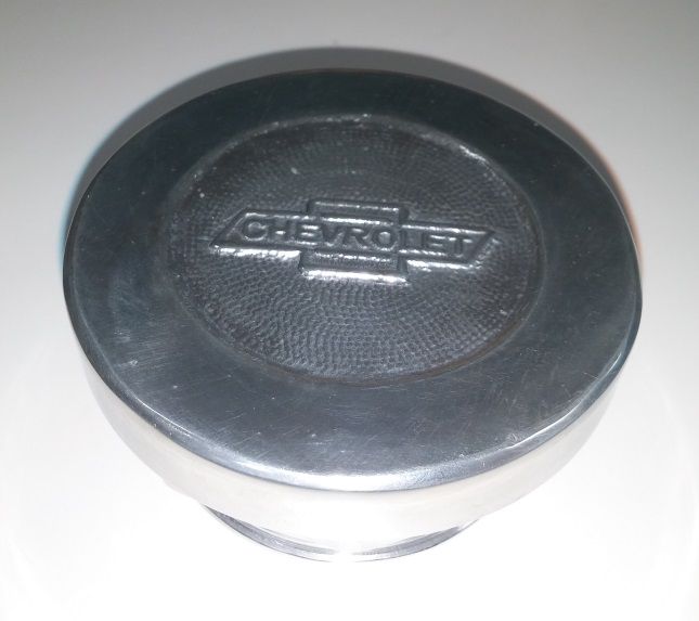

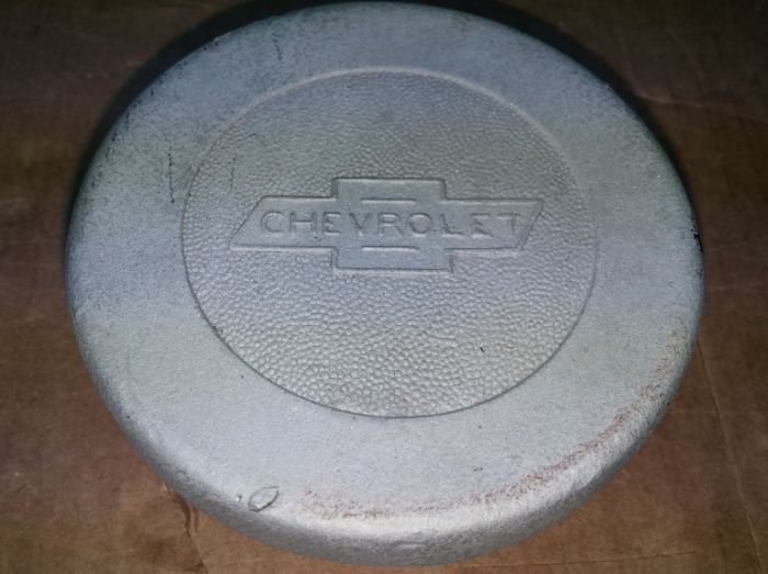

thanks guys !! these are the repros i got
they are cast and a LOT thicker and heavier then the stamped aluminum ones i have.

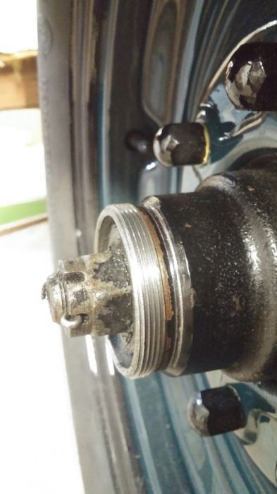

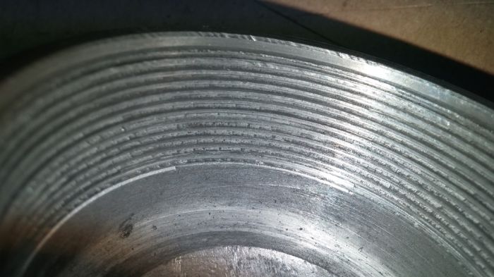

here are some pictures of the original caps I have as well the hub on the car they screw onto.
Here are some of the Repro Hub Caps
New Hub Face.jpg New Hub ID.jpg New Hub Threads.jpg 20190513_082500.jpg 20190513_082521.jpg

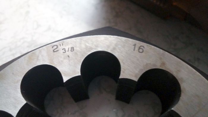

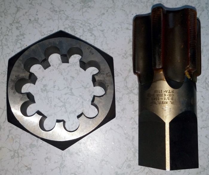

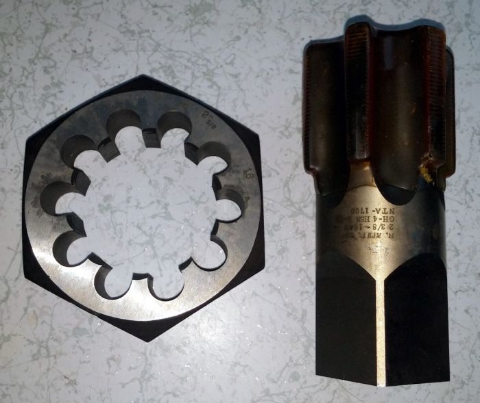

well decided to clean up the chewed up threads on the hubs, as well as chase the threads on my new repro hub caps. problem is they are 2-3/8-16 threads, which is non-standard as well as being a big thread. after talking to a few machine shops around and figuring would have to go lathe, i found a tap and a die on ebay the tap said it was used but in great shape, the die was listed as new. they arrived and when i opened them up they both looked  new never used !! got them from 2 different sellers funny thing they both were in California  got them for a good price considering they usually run about $200-250 each !! that is my price through work.
got them in last nigh and cleaned/chased the threads on the hubs
oh yeah in order to chase the hubs, i did not have a large enough wrench 3.75" across flats to get on the die, so i got it started by hand. then had to use my strap wrench to spin and thread it on. that worked great. i backed it off and ran one more time to ensure clean threads. now it goes on and off completely by hand !!  man what a difference !!!
try to tackle the hub caps this weekend...
I now own a tap and die that big :)

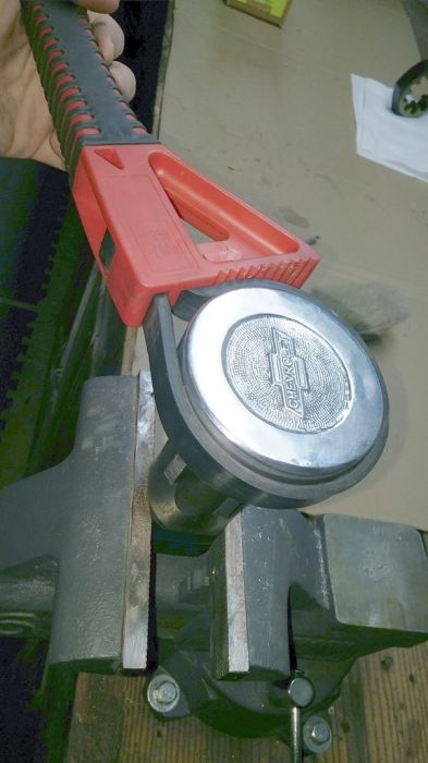

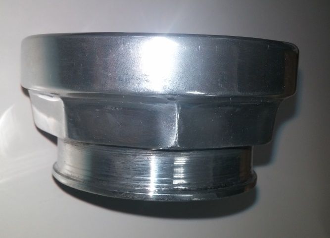

took and chased the threads on the repro hubcaps tonight. that tap cuts that aluminum like BUTTER !!
was very easy and simple to do. i secured the tap in my bench vise, then get teh cap started on the tap and used my strap wrench and threaded wach one on till it bottomed out. then back it off.
now they screw on very easily and smoothly on the hubs i cleaned up last night !!
20190524_205103.jpg 20190524_205142.jpg 20190524_205229.jpg 20190524_205509.jpg 20190524_205539.jpg
