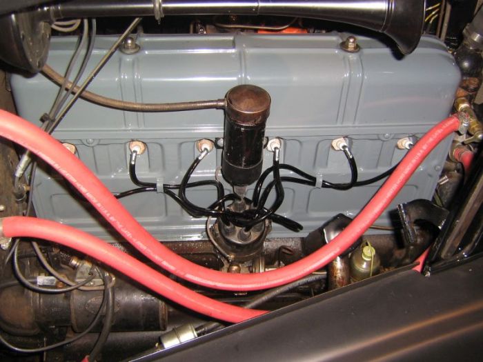

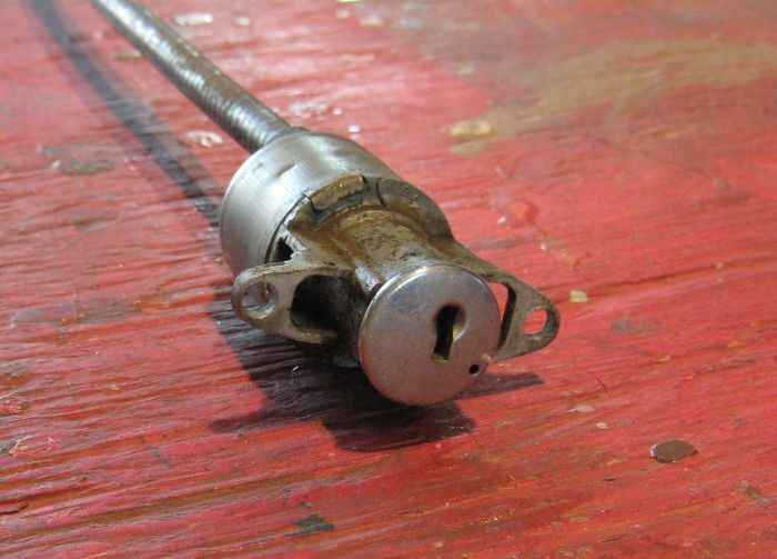

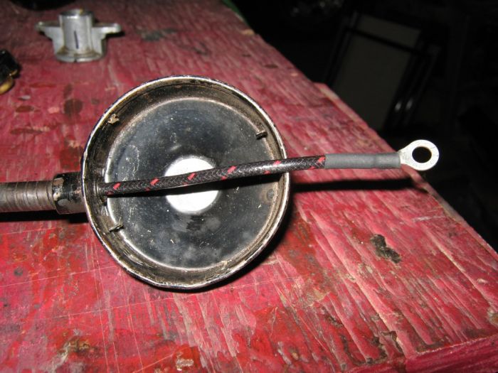

Here a pics of the electrlock from my '38. One shows the key end. One shows the "cap" end and one shows it in place on my car. Do yourself a favor and use a dremel tool to remove the lock tab on the cap that locks the cap to the coil. Removal requires a special tool, many bad words and, as in my case, a destroyed coil trying to remove it. If you grind off the tab it's a simple twist and lift to remove it.
