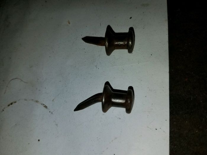

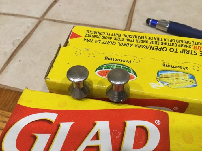

Made up one pair of pins last night because I had a few minutes to spare. Need to make up at least another pair. Turned them on my lathe out of a 1/2 steel round rod. Thanks for the measurements Dave, they made it so much easier. One picture is the two originals from Dave with the bent nail portion. I made my nail portion a little longer but all other dimensions are what Dave gave me.
