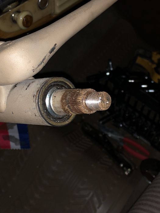

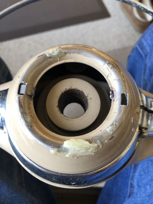

Here is what is in place.
Looking at the cup and the glue on it. I see what they did in the previous repair. They glued the bushing to the back of the cup. Oddly, there was no spring anywhere.
I see the pad, insulators/cushion, the spring, and the inner cup (between the ring and the spring) - links below.
https://www.chevsofthe40s.com/detai...ring_Cup_Screws_and_Insulators_Cars.html
https://www.chevsofthe40s.com/shop/...p;searchtype=FT&method=KeywordSearch
I'm not getting this link http://chevy.oldcarmanualproject.com/parts/1929_54/176.htm where it shows two cups (looks like with the same part numbers) on either side of the ring. Is cup nearer the spring actually the same cup as the one that goes on the column?
Also....look at my cup and the lack of contact point. Is that a concern?
And lastly....my steering wheel was not installed when the wheels were straight. Assume it goes at 3oclock and 9oclock and not 12 and 6.

First thing is to take a screwdriver and lay across the brass bushing and touch the steering column (as seen in the last pic) to see if the horn blows. If so all is good from that point to horn.
That 2.819 is a group number, not a part number. You can see it on both pictures of the two types of horns and the all look different.
It has been so long since I did mine I can't remember exactly what all I did. Anyhow, you can see that the bottom cup is threaded and screws into the horn ring. That is how you fine tune the contact. However it appears one of the contacts is missing, and the one that is there is in bad shape, second pic.
The inner cup is the one that comes with the spring in the top link above and the horn pad you need is the $19.99 one in the bottom link. I don't if the contact are available or not. If the horn blows in the test and you get all these parts I believe you will be able to fix it like it should be.
Yes 3 & 9.

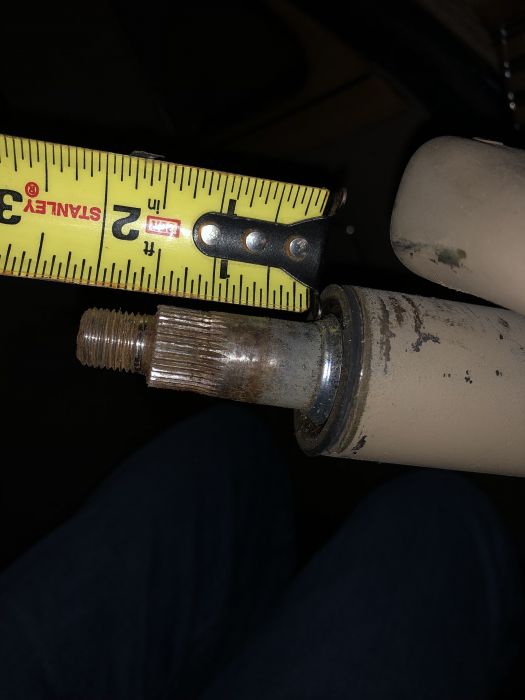

Did I measure this from the right spot to the right spot? Just under 1.5". The manual says it's supposed to be 1.25". I adjust the mast jacket by loosening the bolts where the column attached to the underside of the dash, right? Do I just loosen then adjust/retighten? Or am I oversimplifying? This doesn’t mess with my shifter alignment in any way?

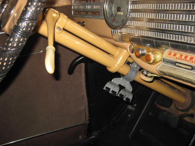

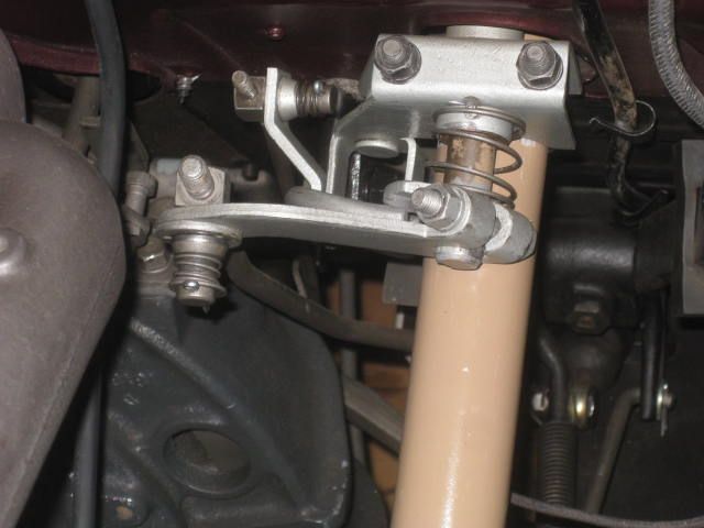

Hi Scott,
Any adjustment of the mast (up or down) affects the transmission linkage which affects the shifting of the transmission. Setting things to the manual specs. while admirable, could result in a lot of frustration getting the transmission linkage just right to make for easy shifting. I think I would leave the mast alone if your car's shifting is good (no grinding of gears, no popping out of gear, etc.) and just see if you can reassemble the horn correctly and get it to work without moving the mast.
You were correct in assuming you need to loosen the dash clamp that supports the mast, but, you also need to loosen the mast clamp at the bottom where it slides over the steering box. Where the mast is clamped to the steering box can be very frustrating to loosen from the box since it can almost rust/freeze in place because of sitting unmoved for so many years.
If you have or do move the mast take a lot of pictures and measurements of the parts you move, and remember to somehow compensate for the distances you moved the parts. Over the years I have had my car (16 years) I have spent hours if not days fine tuning my transmission linkage to get it to manually shift from 1st to 2nd without grinding. I do not have it hooked to vacuum assist, and probably have a few well worn transmission parts that are complicating my problems. Since I live in a community where 90% of the road speeds are 35 MPH or less I don't worry about the speed of shifting. It takes me about 3 to 5 seconds to shift from 1st to 2nd so double clutching or waiting for my synchronizer gear to slow down gears is the way I do things.
Below are some pictures to help decipher your problem, let me know if you need more:
P.S. One thing I have tried to do through the years is only tackle one major problem at a time. While sometimes this doesn't work well usually it does. Horns are frustrating to get to work well as are transmissions, you could end up not being able to drive your car for months if you mix transmission repairs with horn repairs. Pick your poison slowly and continue asking for input.
P.S. #2 I just realized that the picture of my dash mast clamp was before I restored my car. To the right of the mast you will see a horn button attached to the bottom of the dash as well as a Special Deluxe Steering wheel. I know have changed to a Master Deluxe steering wheel with the working horn button in the middle of the steering wheel.
Good luck, Mike
