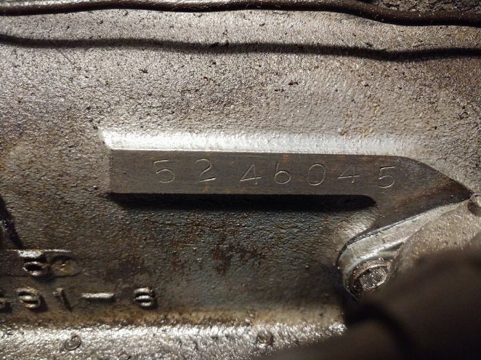

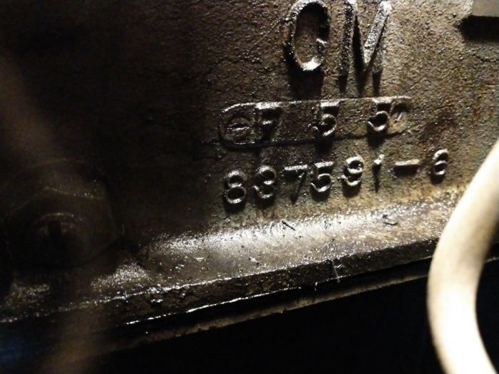

Casting number is 837591-6
Serial #: 5246045 (no T or K)

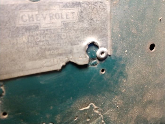

Cowl tag # (but it looks like it should be nailed to the wood as it has 4 small holes for nails in the four corners) 21D327 41 (the tag is chewed up so I don't know if there is more numbers.

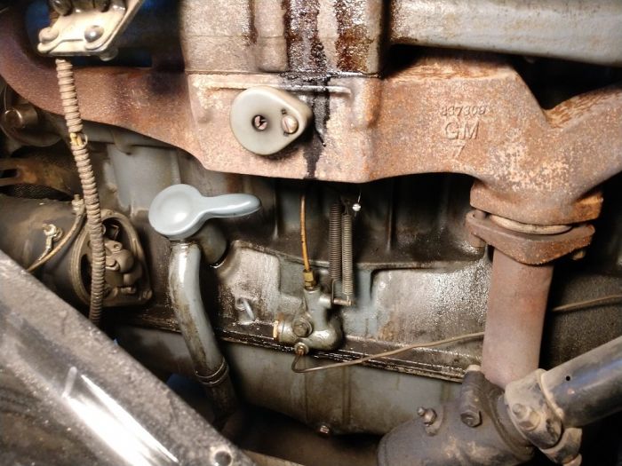

Exhaust manifold: 837309
So it appears to be a 35' motor and because there is only numbers in the serial number, that motor is a car motor?
IMG_20180301_104547822_BURST000_COVER_TOP.jpg IMG_20180311_181740702_LL.jpg IMG_20180311_181804313_BURST000_COVER.jpg IMG_20180311_181907143.jpg IMG_20180311_181930606_LL.jpg IMG_20180311_182112809_LL.jpg IMG_20180311_182130455.jpg
The casting number indicates 1935 engine. There also should be a casting date with month letter, one or two day digits and 4 or 5 which is the last digit of the casting year. The engine serial number would indicate ~ 4 months from the end of production.
The serial number tag with the four corner holes translates as follows
21 = Janesville, WI assembly plant
DB = 1934 1/2 ton
27 = unknown or not accurately read. Should be one or two digits from the assembly month 1-12
space
sequential number beginning with 1001 for first assembled.
The engine number does not have a letter prefix which indicates it is from a 1935 mASTER dELUXE PASSENGER CAR. tHIS IS IMPORTANT BECAUSE THE EARLY sTANDARD AND TRUCKS HAD A 1934 mASTER TYPE HEAD. tHE HEAD YOU HAVE WILL HAVE THE IMPROVED SPLIT KEY VALVE KEEPERS ETC. aLSO THE WATER PUMP FITS 1935 ONLY THE THE CONNECTING RODS HAVE THE NEW FOR 1935 PRESSURE STREAM OILING.
The oil filler cap is from a 1935 because it has the big ear on it. The fuel pump is a 1934 as it has no glass bowl filter.

My '36 truck had a 216 fuel pump when I got it. The base is different but close enough to mount up. I don't think the lever is quite the same shape but it must have worked at one time. I think that is the pump I am seeing in the photo. I seem to recall the '34 base uses two bolts which are diagonal to one another so I don't think it would could be used on this engine. '35 and '36 share a fuel pump, AC number is 421. This pump is also used on some Buicks and Diamond T trucks.
The 1934 fuel pump is the first to have the bolts directly across from each other. The 1934 fuel pump had no glass bowl. It will fit directly to a 1935-1936 engine. The 1935 and 1936 fuel pump has an inline gas sediment bowl, that is the only difference....The 417 is the 1934 pump and also fit 1934 and 1935 Buick series 40 engines. The 1935-36 pump is a 421.THhey both use the same diaphragrams.
