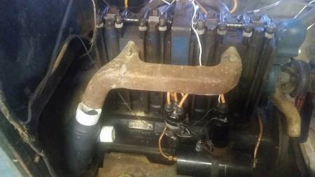

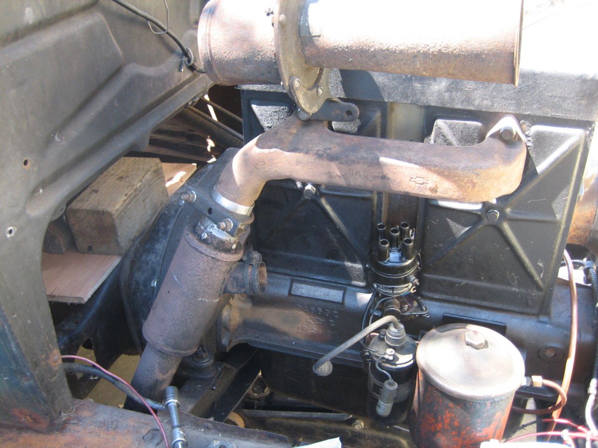

Below are a couple of photos that illustrate the relationship of a '28 exhaust manifold and '27 firewalls.
Keep in mind that these pics are trucks (1/2 ton (same as car, but different firewall) and one ton). I do not know the dimensions or configuration of the earlier firewalls, which is what your question is all about.

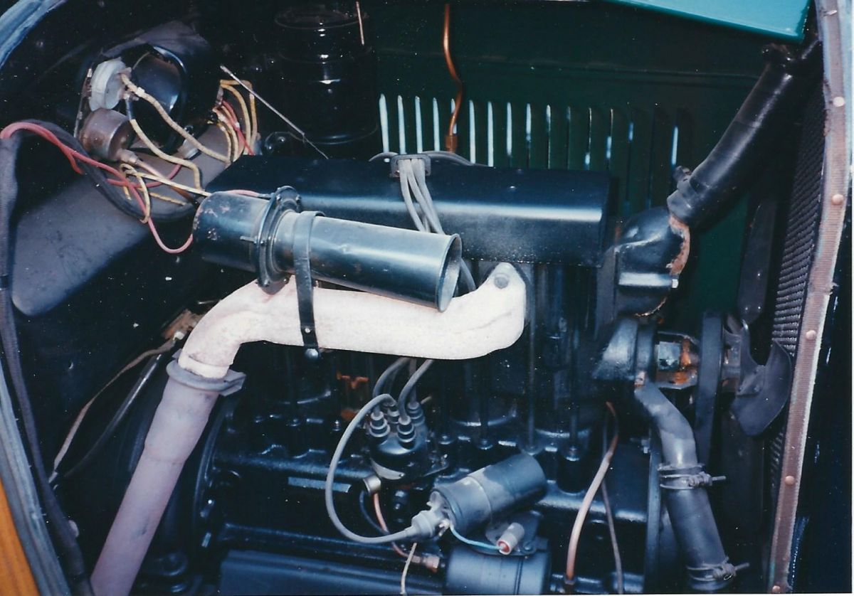

Here is a pic of my engine bay, '28 motor with '28 exhaust in my '25 sedan.
