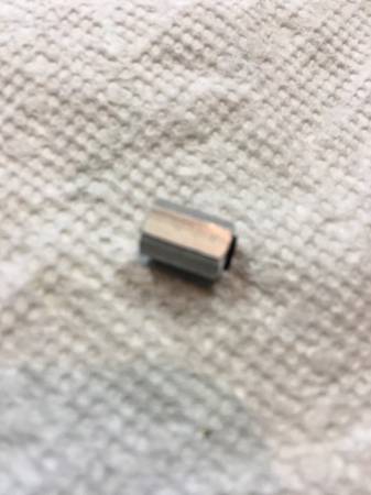

Took my Carburetor off the '29 tonight and this is what I found.
Before I pulled the carburetor off the engine, the needle was going up and down.
Unfortunately I dropped the needle on the ground off the frame and this is what I found. See below.
I guess I have problems. Is the point missing from the needle? Is this a Viton Needle? There was no number on the needle. I guess I need a new needle and seat.

Yes, that is a Viton needle. There are two types of needles with Viton....one is pointed on the end and the other is flat on the end. Your needle is the flat Viton type.

There is nothing wrong with viton tipped needles except in gravity feed systems they NEED a clip which connects the float lever to the needle so the lever pulls the needle off of the seat as those needles have a tendency to stick in the seat....... curse
In your case, having a fuel pump, that won't happen.
Check out that >>> Needle & Seat

The fuel valve pictured is the Parker Brothers style. I won't argue with others whose opinions I respect concerning their value or quality, but we used them for 40 years with NO issues on literally thousands of carburetors.
The point to this post is: the Parker Brothers valve, in addition to using the flat neopreme end on the plunger, used an inverted flare in the seat. You CANNOT replace this plunger with a metal one. If you replace, you will have to replace both the plunger and the seat. The original style metal valve will NOT fit in this seat.
