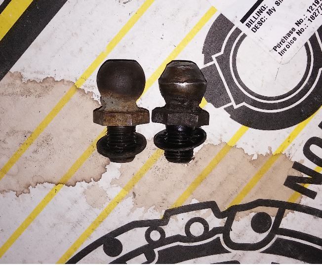

Okay I found a potential problem that might be giving me some excessive Slack when I went under the car and started pulling down on the pedal I can see the arm that the throwout bearing is connected to has a little bit too much movement on it so I think the clip that hold on to the ball is wore out or maybe the ball so under again I go.

update , I changed out the throw out bearing arm clip and it still had play so them changed out the arm pivot ball and that did the trick, thanks everyone for your input.

Thanks for the heads up on your solution. I am assuming from your past posts that the throwout fork ball was not the correct size for your throwout fork, or the ball was badly worn. Which was your problem?
According to the 29-54 Chevy Parts Manual the same ball .0796 was used from 38-54.

the ball was badly worn which gave more play on the peddle. Since the car wasn't running when I bought it I didn't know of this till I got to that point. Also I have other throw out barring forks and made sure I had one that wasn't wore out too.

here's was my problem
