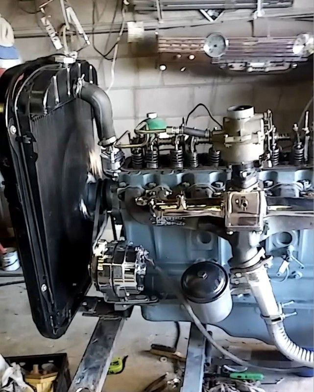

I bought 2 types of innerline filters trying to use on my motor with the Fenton split manifold for my 216. Couldn't make either of the 2 work so I used witch ever of my exhaust manifolds that I could get to work for my 41. I had to build the exhaust system any way so that made it more easier. Bot either way I was determined to use one of them cause I like the look of it.
[Linked Image from img.photobucket.com]

Very nice looking motor there! So this is really interesting. I have the one in the top photo. I saw one on Ebay the other day that was different again in that the top was a heavy casting with the Inner Line name prominently displayed. So now I am wonder if the ones without the names, like mine, were some kind of clone.
The one with the long neck was designed to get past the side motor mount bracket on a 1952 (also '53 stick)
They also made one with a taller cover and it used a taller element.
No matter what they tried by 1953 they were dead and could not be used on Power Glide engines or any 1954.
