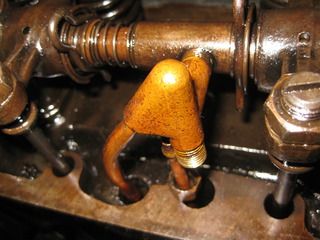

[Linked Image from i1055.photobucket.com]
My 29 should be the same. The copper tube seen hanging down was turned up and fastened to the fitting in the enter of the rocker assembly. You can see the discharge elbow which sends excess oil down the drain tube. If you are missing the tube, one of our members used conduit.

Thanks Man you are a life saver I'd like to trouble you for one more price of information what size is the copper line running though the block
A little bend in the small oil line on the pushrod side of the engine will let any oil drip off before it drains out of the hole to the other side. Alternate is a wire wrapped around the line to direct any drips away from the tubing. In actual operation very little oil will follow the line as long as the fitting is tight and the drain tube pictured is in place. The tubing is 1/8" copper.
3/16 O.D. 1/8 I.D.
