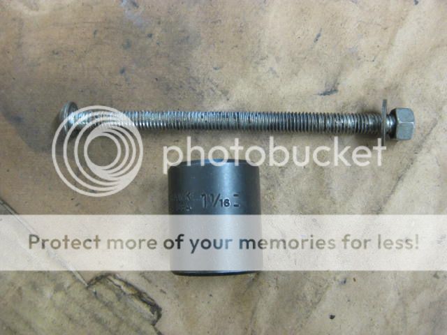

It is easiest to replace the shocks with all the front sheet metal off the car. The inner fenders are very close to the nuts holding the shocks to the crossover member of the front suspension. Try to use only sockets on the bolts. You will need a good impact wrench or a breaker bar to loosen the nuts.
I will provide more info on actually removing the shocks later with some pictures. Good luck, Mike

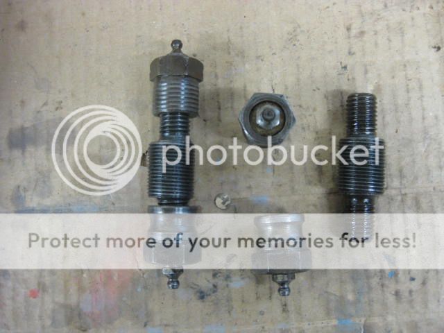

I look forward to helping you. I am busy most of today so will get back to you probably tomorrow. Unfortunately, you will not be able to fluid check your shocks with no engine weight on them. But you can try to check for leaks by bench checking them once they are off of the car. My pictures will show what a leaking shock area looks like.
Since you have the car apart I would strongly recommend replacing the shocks. I would also not buy shocks from any ebay source. For the money/time you invest, you need to know that this is a reliable repair. I can also walk you through rebuilding your front suspension.
You should replace the rear shocks, and that is a lot easier. If the car sits level in the back I would leave the springs alone, just clean them up and make sure the grease fittings for their mounts are functioning and have good rubber bushings. Good luck, Mike

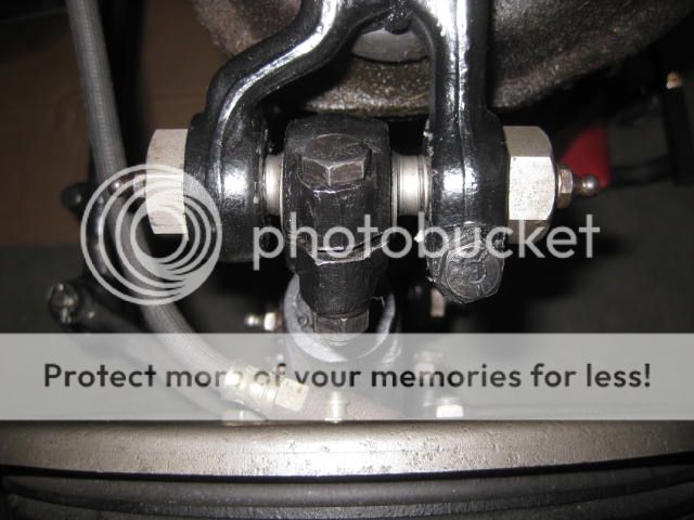

Front shock replacement in progress. The large pin has me thinking I’m bot smart enough to get it together. Any special advice you could share? Korhonj@gmail.com. Thanks
Joined: Apr 2013
Posts: 250
Joined: Apr 2013
Posts: 250 |
Hello JAK40. It’s been seven years ago since I removed all of my shocks and had Apple Hydraulics rebuild them. So, it’s a bit foggy on how I proceeded. The above posts should help, especially Mike Buller’s excellent photos and helpful posts. If you have the 1940 Shop Manual, go to page 65. There you will see an excellent cross-section of the Upper Control Arm Assembly. Just read up and study the photos, removal procedures and you should have no troubles. I do remember that after you remove the bolts on each side, you use an Allen wrench to remove the inside “pivot pin”. See above photo on Mike Buller’s post. I’d be extra careful to make sure there are no hidden “loads” on the shock and to make sure front end is secured as recommended in service manual (jack stands,etc.). I highly recommend Apple Hydraulics for rebuilding. I sent all 4 to them. www.applehydraulics.comThe rubber seals that go between the front bushings/control arm and center part of the pivot pin will need replacing. They keep the grease inside. Those can be purchased from Chevs of the 40’s or The Filling Station. Good luck, Curt
