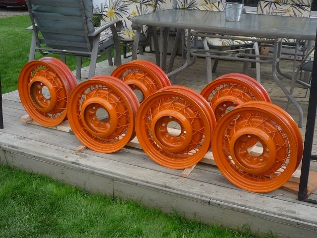

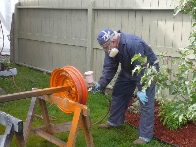

This is how I did mine. I rotated the wheel in order to always have the gun in the same position.
When I painted my wire wheels I used a professional (Binks) spray gun and I had the spray pattern adjusted to a small fan so that I could get behind the spokes, inside of the hubs and etc. I also put the paint on wet so that it would have good flow and also have a good shine when dry. But, you have to be careful when applying the paint wet to avoid runs and sags.
