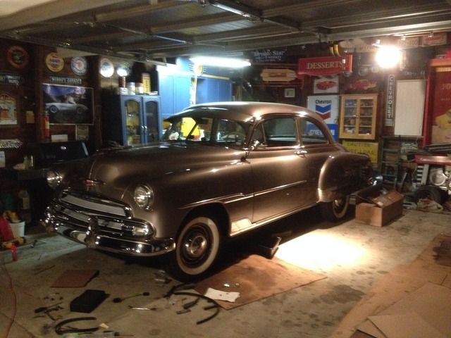

After she went to bed I went out to the garage and bolted the bumper on while listening to the Blue Jays lay a beating on the Kansas City Royals! What a great night!
She almost looks ready to go...

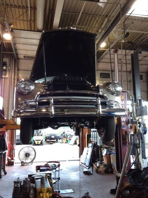

Yesterday I trailered it up to the muffler shop for an exhaust pipe and a front end alignment. They did the alignment today, and are going to tackle the exhaust in the morning.

I stopped in to see how it was going. The Grandpa of the guys that own the shop hangs around and keeps his hand in on the jobs he finds interesting. Needless to say, he's been all over my '51! They had nice things to say about the "very professional bodywork". Thanks again to Kerry Anderson... great to see that guys in your field are also impressed. The Grandpa also showed me a little secret from back when... he custom built a sleeve that goes up inside the ceramic exhaust doughnut right below the manifold. He said that it will keep that doughnut from cracking over time, and I'll likely never need to replace it.

When my friend did my exhaust he did the same thing by welding a sleeve in to keep the donut centered.Before that the donut kept burning up because the pipe kept on loosening up and I would end up having a loud exhaust leak.Solved the problem.The Truck and Car shop in California sells that sleeve in their catalog.
On the factory pipes the sleve was an extension of the pipe. The sleve slipped over it and the packing was about an inch from tne end of the pipe so the exhaust never touchec the ASBESTOS packing.

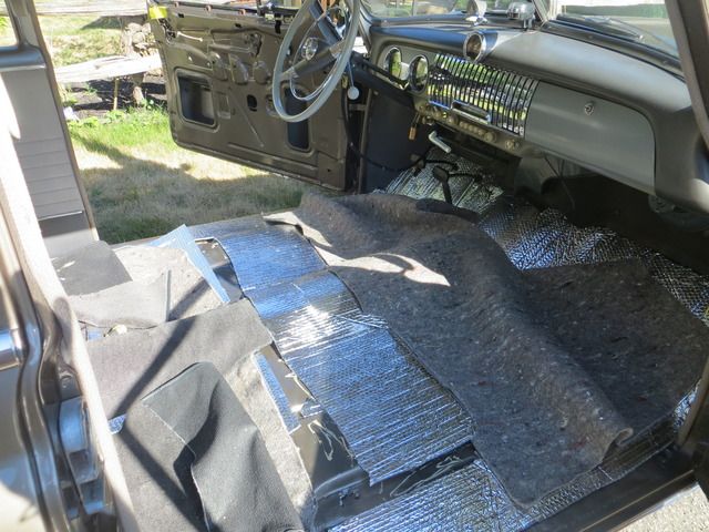

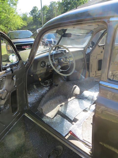

I've spent the last three days working on the interior install. The carpeting came from National Chevy Association. I decided to put down a layer of foil insulation to keep some of the heat and noise out. One thing I've noticed is that without the 200 lbs of undercoating, the car is pretty loud now.

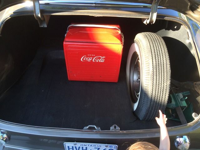

Last week I wasted an afternoon cleaning and painting the bumper jack that has been in the car for as long as I can remember. I made the mistake of assuming it was the original. It turns out that the original had worn notches on it, so Dad threw it up in his barn and put one from either a Plymouth Valiant or a Dodge Aspen in the trunk of the '51. I made the mistake of googling after I did the work instead of before! Anyway, Dad checked the barn and brought me the original Canadian jack. Up here they were green.

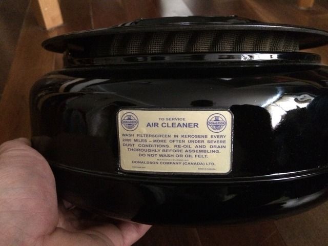

Today I printed the photoshopped Donaldson Air Cleaner decal onto decal paper. It took about 5 tries, but I finally got one that didn't come apart. A great big thank you to 1931Roadster (Paul Rozon) for his help in completing this task. I'm going to touch up the edges when it dries.

Looking great be careful with the foil as it doesn't breath and I had moisture sitting in the floor boards. I took mine out and bought an adhesive type of sound barrier (twice) as mine was loud too. I put the upper front door frame moldings on and that helped the noise factor too. Still need to put the inner rubber fender flaps if you will on but I should have done that before the doors and or front fenders on as there is no room to work in there now.

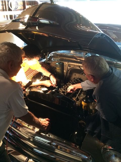

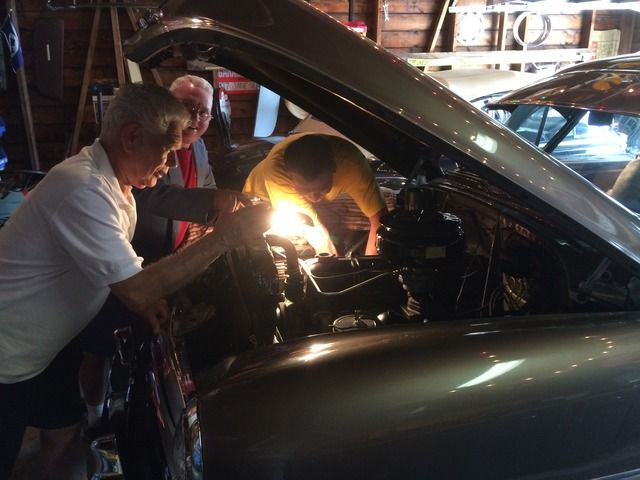

Paul Rozon (1931roadster on Chat) offered to help me take care of the timing issues. Smart man that he is, he decided to turn it into a VCCA Passport Tour. He brought along his own personal mechanic, George Worren, and his personal light and drink holder, Les Gadjacs. Maggie, Carole, and Beverly came along to visit with Abby and Jane as well.
First up it was the timing issue. The car was set wrong, so we advanced it up and had it running smoothly. There was a bit of valve clatter, so we took the valve cover off and adjusted them up to snuff as well. A quick fix of the valve cover stopped an oil leak as well.
Here's the gang under the hood. Paul is happy to work on clean parts. Note Les's awesome work on the trouble light. He's found trouble!

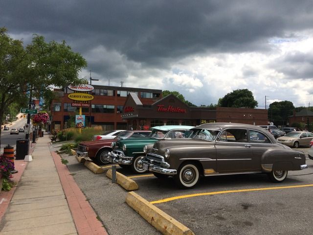

After we buttoned that up we took it for a 5km run to the Tim Hortons around the corner from my house. Something was drastically wrong. It was missing and snorting. Up went the hood, where we found the #2 plug wire off of the distributer. I think we had Paul in charge of electrical... but I'll have to check with George on that. Until then, he's on probation!
Here's the 3 Chevys at Timmies.
We made Les park on the other side of the lot, as he left his '61 Impala at home in the middle of a transmission swap. Instead, he showed up with this little number...

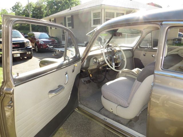

After George, Paul, Les and the ladies left, I got to work again. First I installed the upper loop belt for Abby's car seat. My truck had an extra loop in the back, so I removed it and it bolted right to the frame behind the rear seat, with the aid of a great big fat reinforcement plate and washer. Afterwards Jane, Abby, and Auntie Karen (Jane's Sister) went for a ride. The car drove like a dream. I can really tell the difference in the rebuilt front end.

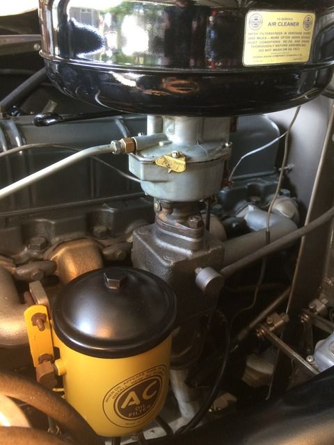

Finishing details today...
Abby points out the painted jack and spare...
The Canadian AC oil filter decal, Photoshopped by Paul Rozon.
If you have it judged I can see them taking off points for the air and oil filters. Make sure they know that different units were used in Canada. I am sure there are other things different also.
I can't see losing points on the oil filter. It's an AC and says "Made in Canada" right on it. Should be self explanatory. The air filter may confuse people though, as it is a Donaldson unit, and I'm sure you're not familiar with them down there.
If it were my car I woulld attach a note on the air cleaner noting it is a Canadian car and in Canada GM used different suppliers.
If nothing else talk to Roger, the chief judge, ahead of time so he could mention it a the judges meeting..
