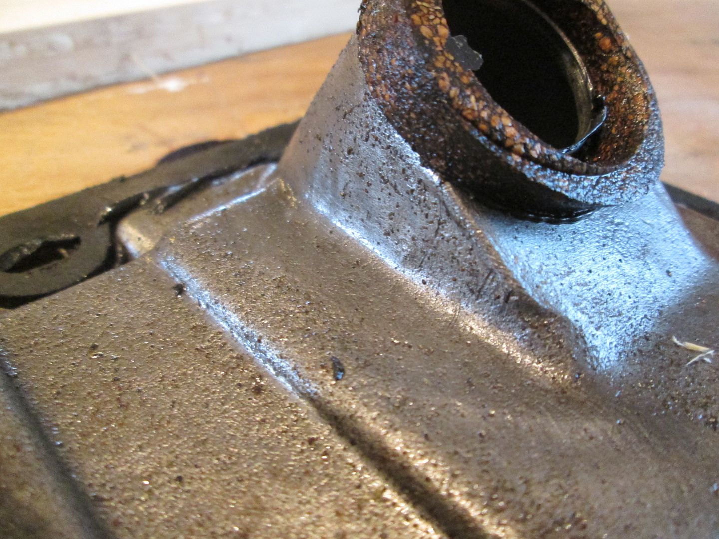

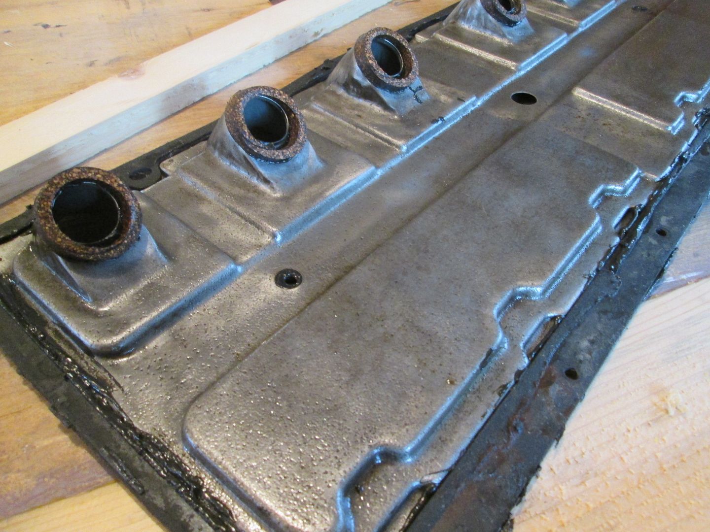

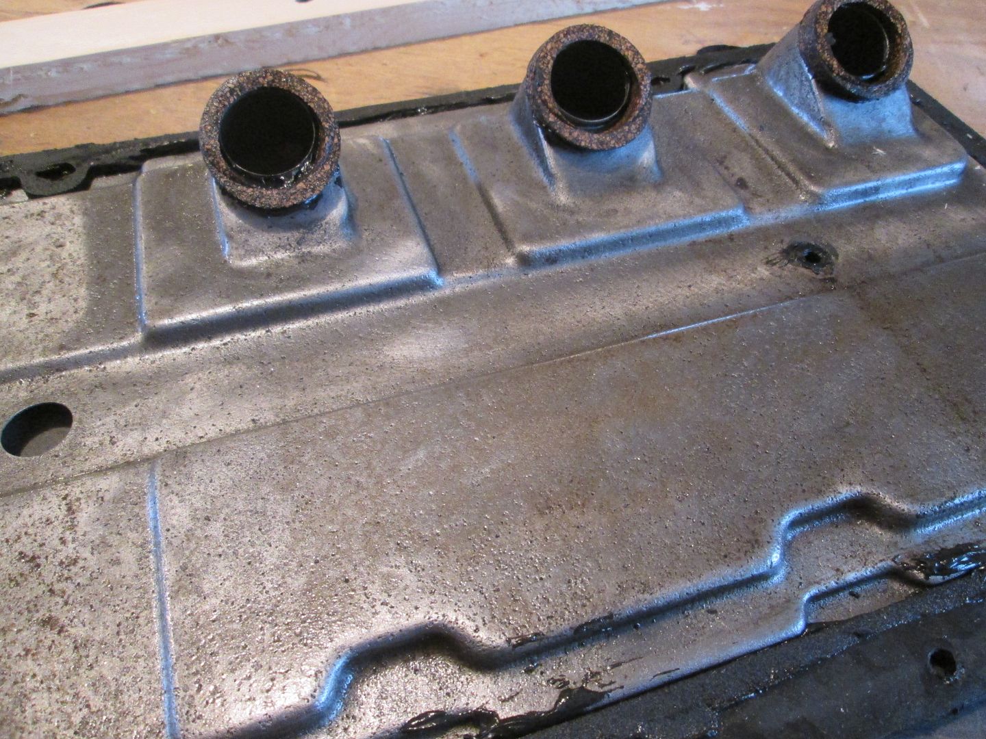

Hello Pat,
I had a similiar "upper end " noise that turned out to be a push rod hitting the side cover as it rotated.
The push rod cup was not centered in the stem of the push rod and as it rotated it would bump up against a "wrinkle" that had formed when the factory stamped the side cover.
With the engine idling, I used a long screw driver placed against the side cover and placed my ear against the handle. Once found, I removed the valve cover first to see if there was an obvious bend. That was when I discovered the taping sound was in unison with the rotation of the push rod as the engine was idling. I removed the side cover and found a shiny spot on a "wrinkle" next to the spark plug pocket. ( All of this happened after replacing the gasket on the side cover. ) I also noticed that I could "shift" the side cover from front to rear because of the free play between the size of the screws and the hole diameter in the side cover. After making my clearance adjustment that I describe below, I made sure to hold the side cover toward the front of the engine as I tightened it in place.....noise gone.
I placed a large drift punch along the wrinkle and using it as a dolly, I hammered along the length of the drift punch to try and create a long depression so the push rod would clear.
I did roll the push rod on a piece of glass to be sure it was straight. I also noticed that all of the push rods had varying degrees of rotational off set so you may have more than one rubbing.

OK. It looks like there is nothing hitting the side cover. there are no marks anywhere, not even near the spark plug bosses where it is closest.
And Gene figures it isn't a rod sound. So that leaves piston pins or the piston themselves. I guess i'll try the plug shorting bit again to see if I hear a difference. There is more than valvetrain noise there.
