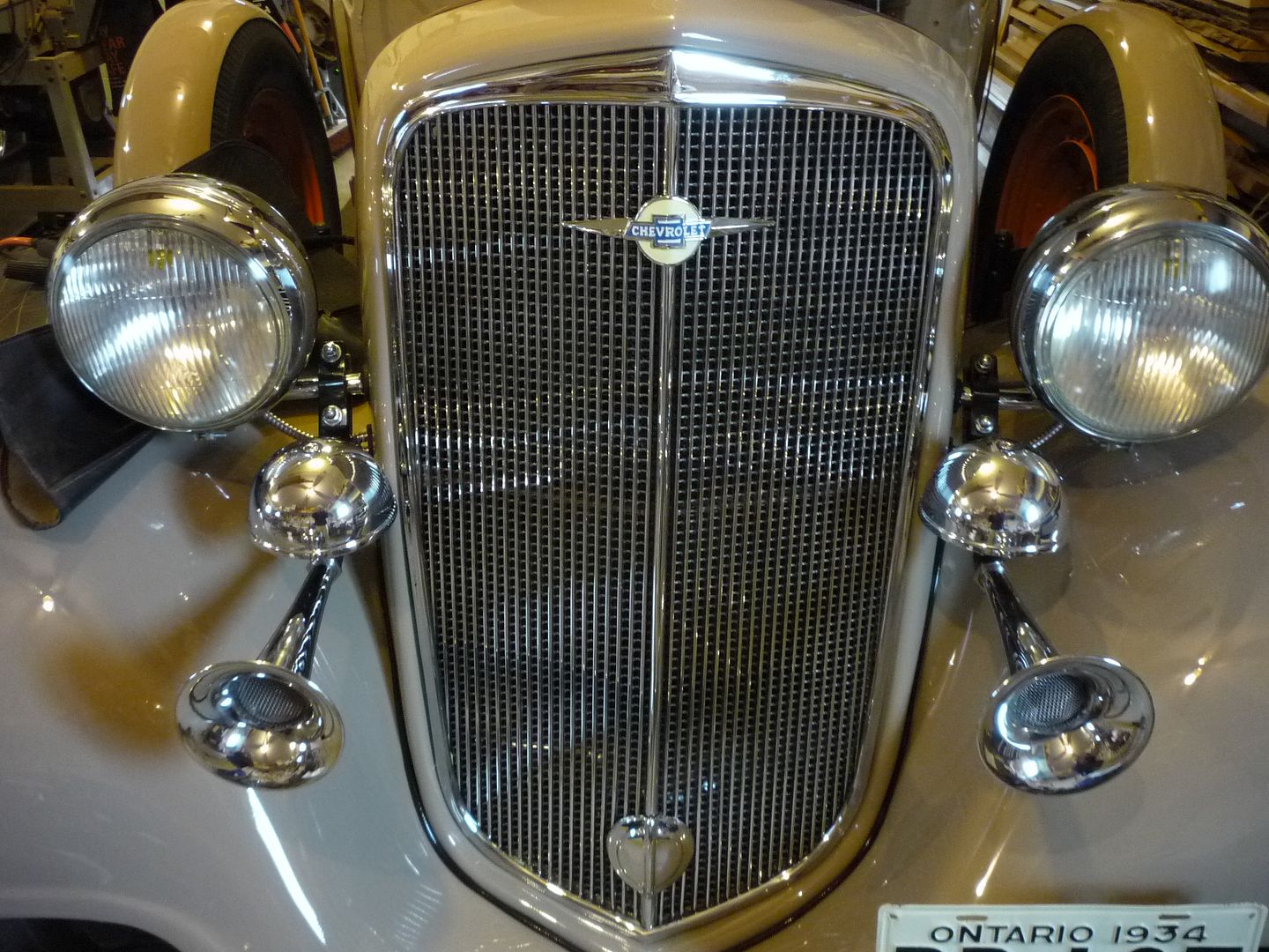

I am restoring a 1934 master sedan and I am wondering what route you guys go when it gets to the chrome parts. Grill, door handles, hinges, headlight buckets, etc. Do you try to buy new, some hard to find and very expensive. Do you have them rechromed by a reputable shop, also very expensive. Has anyone had parts rechromed using the Cosmichrome method? Looks to be very interesting. Does anyone have any experience with this?
door hinges are not plated.
tail light mounting arms are not plated.
depending on condition of the grill mesh insert, probably makes more sense to buy a stainless steel reproduction. Plating on these using copper to fill surface problems to start, can mean many times dipping in copper tank and buffing surface smooth before nickel and chrome.
Its the face of the car and its important to have that part done correctly and the trim ring. Plating can really add up quickly $$$$$$$$$$$$$$$$$$ .
Because the 1934 master DA outsold the standard series in 34 by a ratio of almost 7--1, you got a better shot at finding the parts you need.

However, if you send your parts here, you can look at considerable savings. I had excellent results at The Plating House, just North of Toronto.
In my case I had the lights, from a parts car. The grille surround was also from the parts car but the insert was purchased on eBay. I think I was lucky with that one. I asked the plater to do just the faces of the bars.
