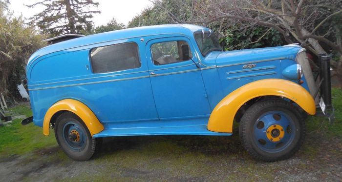

GM offered a variety of optional wheels. Half ton and passenger came standard with 8 spoke 16" wheels. Two rim widths that I know of depending on optional tires. 18" wire spoke were optional where high clearance was needed. (They are different than 1932 - 33 wire wheels.) 15" artillery were standard on 3/4 ton and optional on half ton. (See picture) An 8 spoke 17" was standard on 1 ton and only one that can be used on rear 14" brakes. All Ton & half had 20" pierced disc wheels in a variety of widths from 6.00 to 9.00. Special running boards and rear fenders were required with 8.25 and 9.00 X 20. (See second photo.)
