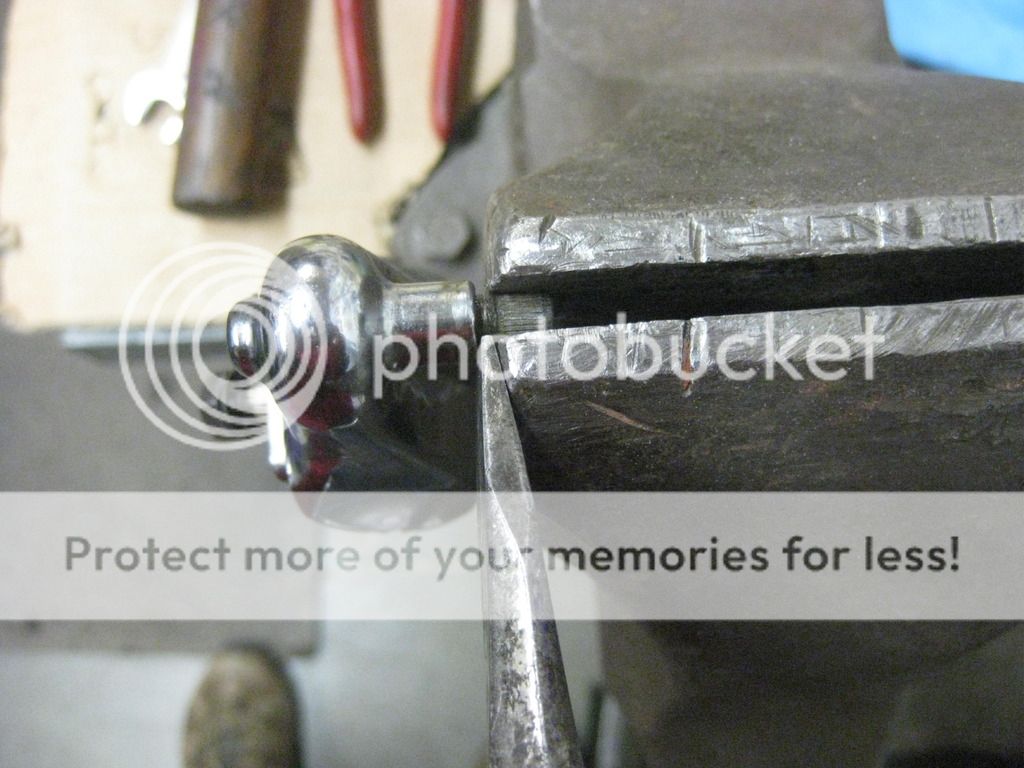

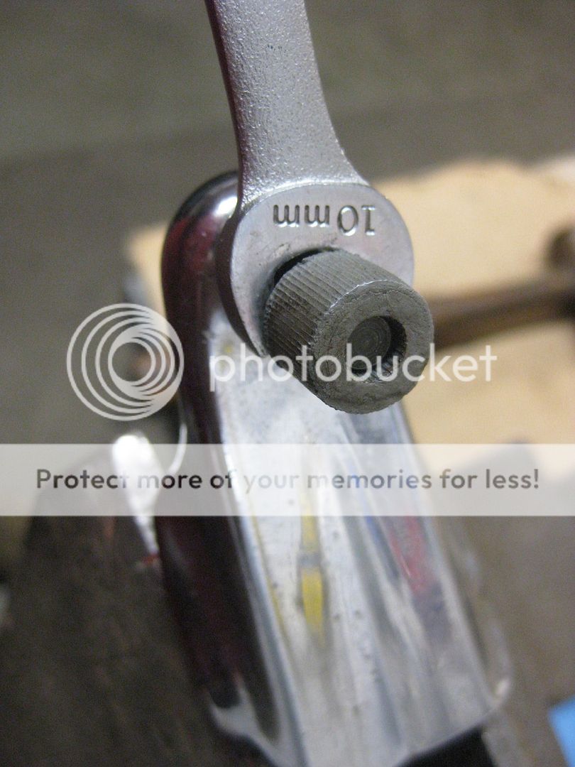

Below are pictures of a wiper transmission. The first shows the cape that the wiper arm is pressed onto. The second picture shows a 10mm open end wrench which you can slide under the neck of the transmission. Using a a small hammer you can strike the bottom of the wrench as the transmission is held firmly in a vice. Take your time so as to not damage the bottom of the cap as you drive it off the shaft.

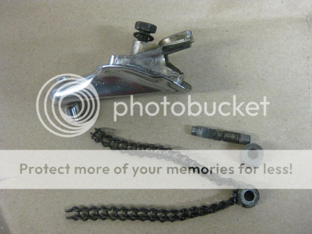

The next picture shows how to use a large screw driver to pry out the shaft. The last picture shows all the transmission parts. When you remove your shaft you may still have a fiber washer resting in the indentation in the center of the shaft, it is for lubricating the transmission. A lot of times the washer has disintegrated. You can try and make one out of a piece of felt or just pack the area with grease when you reassemble the transmission.
