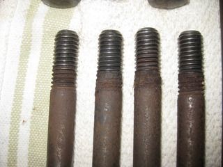

These are some of my bolts seeing daylight after 30 years in the dark. The ones on the pass side look oily and fairly smooth. Their twins on the manifold side look pretty beat, all rusty, dried out. Must be that hotter, harsher environment.

pass side
[Linked Image from i109.photobucket.com]
manifold side
