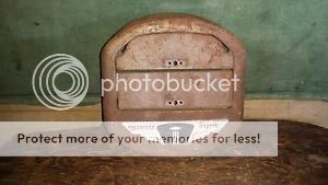

Is this it???
[Linked Image from i563.photobucket.com]
No. I will send you the correct.
CC, That's what I have in the 41 coupe now. I see many of them but I don't believe it is the right year or the deluxe one. Thanks, though.

I believe the two door heater posted is for a 1942-1947. was the only other years that used a verticle door heater.

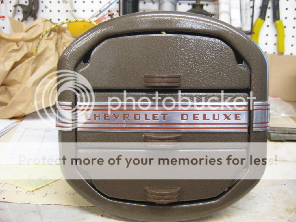

This is a heater I restored for my 41.

Very nice!!!

Mike,
That appears to be the Deluxe heater. The one I want to have is the Super Deluxe.
Still three doors but broader "knobs." Yours appears to be a genuine 41 though.
