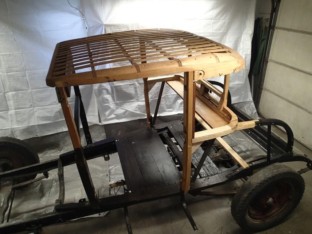

Below is a photo of my 1927 Chevrolet coupe skeleton as it presently stands.
[Linked Image from i1151.photobucket.com]

Looking good Dave.

nice looking kit,mines a touring car,need wood for the doorsa as well,where did you get yours from
