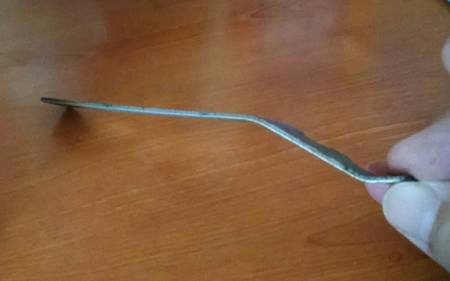

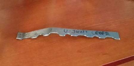

Regarding the u joint tool, I made my own. Simple piece of steel bent into a shape that works.
While holding the tool behind the u joint to keep it forward, I put one or two nuts on with my other hand. Still an operation in dexterity, but easier with the tool.
