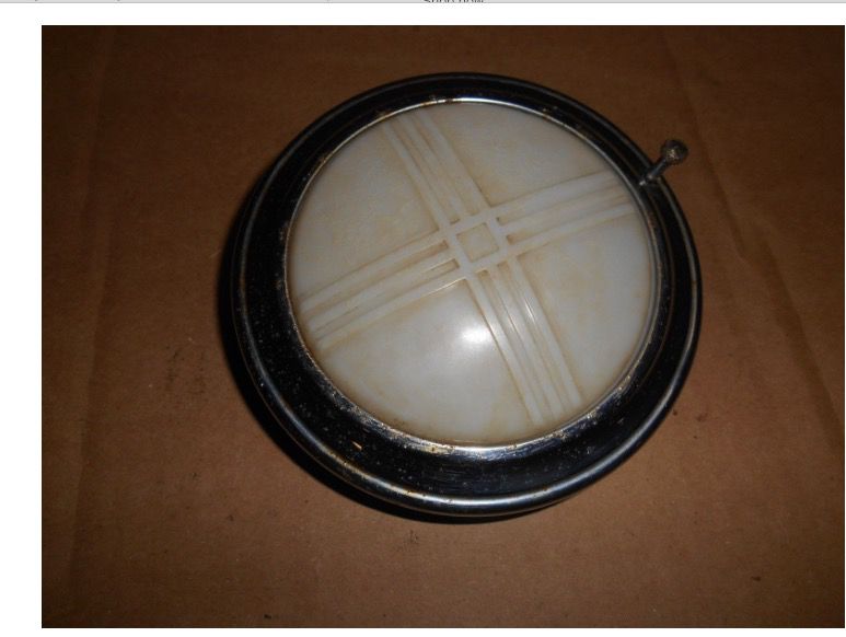

[Linked Image from i1365.photobucket.com]
Oh, that knob. I found this pic on the internet. Thanks all.

The dome light on my '35 Std coupe is exactly as is shown in
the picture, Pulling down on the knob turns the light on, pushing up turn it off! Flip
