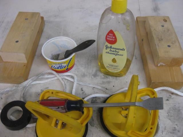

I used Baby Shampoo for my lubricant, a chemist friend recommends Joy as best. I used it straight from the bottle, no dilution. I applied it all around the inside of my pinch weld making sure I got the right and left sides real well. I also lightly covered the tape on the weatherstrip. I wanted the tape to be slippery but didn't want the soap to start softening the tape edges.

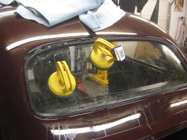

I used my suction cups to mount the window struggling a little to get the ends of the ropes on the outside. I used the ice pick to hold the window in place at the bottom. I secured the top with my drywall nails, with a lot more patience I could have used garnish screws. I released my suction cups and then installed them on the outside of the window.
Because of gravity and comfort it is best to start from the bottom, middle of the weatherstrip. Your goal is to just get the edge of the flap about 1/8" over the pinch weld and work around to the sides. You do this by carefully lifting the rope up which causes the lip to raise up and over the pinch weld. If at any time you are feeling a lot of resistance do not pull hard. Instead use a gasket scraper and pry the rubber flap up in front of the rope, work the rope forward removing the scraper. If you can only go a few inches without having to tug on the rope then just take your time until you can move the rope more easily. Remember your goal is only to get the flap a little over the pinch weld. If the flap slips down behind the rope then re-pry it up with your scraper or a 1" stiff putty knife. If you are right handed begin up the right side. Any time you hit resistance keep prying. Every time you meet resistance apply more lubricant with a 1" brush. Try to keep the entire rubber weatherstrip saturated inside and out to promote easy movement.

These items are must haves... Soap, padded wood block stands for setting the glass onto when mounting the rubber weatherstrip, electrical tape, a gasket scrapper for prying on the rubber, 1/4" rope, suction cups, small container and paint brush for applying the soap lubricant.

Window installed. I did remove the electrical tape as it got in the way. Small suction cups are a must for working alone.
