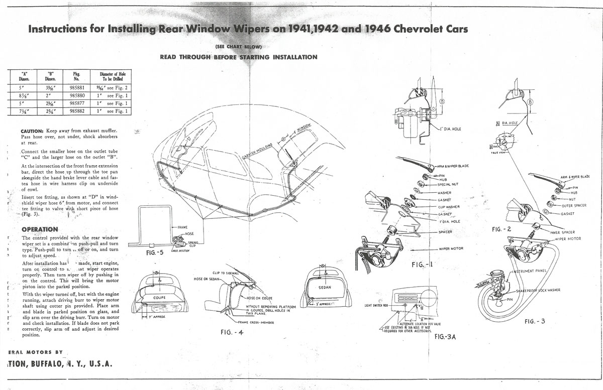

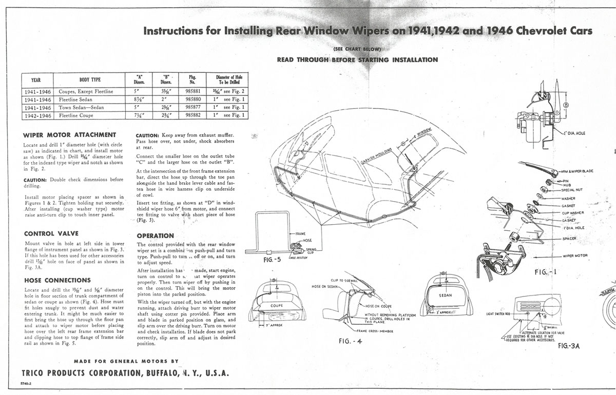

From left to right:
1st hole is for mounting the dash, of course...
2nd hole with smaller hole in front of it is for the hood release.
3rd large hole is for windshield washer unit switch or rear wiper switch.
4, 5 & 6th holes (triangular pattern) for convertible switch bracket.
7, 8, 9 & 10th holes for defroster, heater, fog and fresh air unit switches. fresh air unit instructions tell you to use the hole nearest the steering column.
11 & 12 slotted holes for steering column mounting of course....
Note: See instructions specific to Chevrolet only, Not generic GM for the rear wiper unit and it says to use the lower factory hole on the dash if unused, and states it is an alternate location. The true location of the switch is on the face of the dash as shown.
[Linked Image from 1948chevy.com]
Under hood light and trunk light have built in mercury switches and only require power and grounding. the original back up light switch mounts to the shift linkage under the hood.

WOW, Johnny, great job. Thanks dance
Is their some way to put those sheets on your site in a larger size?

thankuJohnny more then I expected...I never thought about the convertible switches...I knew you were the Accessary King

So I finally built up the courage to drill some holes in my Fleetline - four of them, in fact. Following the instructions that Modiol and Conv48 posted (thanks guys) I think I drilled them in the proper places. I ran the hoses along the frame, hooked them up to the motor, then the switch, and unbelievably, the rear wiper came to life! When I turned it off, the parking feature worked and it returned to rest. No leaks for the moment. It was a sight to behold, I'm telling you...
