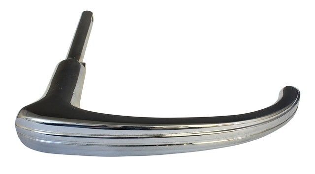

The trunk and passenger side door handles look to be the same by outside appearance. I don't know off hand if they are the same on the inside where they connect to the mechanism.
Trunk Handle.
Door Handle.
Edit: After looking at the photos on The Filling Station site they do not interchange, they are different on the business end.

they are also different on the outside…trunk handle is "stubbier" than the door handles…Billu38

Don't stress that hip Tiny! Let me save you some steps…6-3/4 inches along outside of door handle and 5-1/4 inches for the outside length of the trunk handle…Billu38

from filling station
[Linked Image from i957.photobucket.com]
trunk handle
door handle

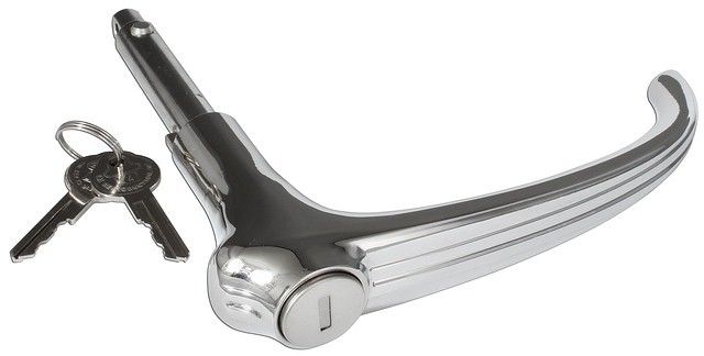

door handle with lock

I&I reproduction is great... bought one locking door handle and months latter decided to put one on the other side too....
They went out of their way to find me one with the same key number....
