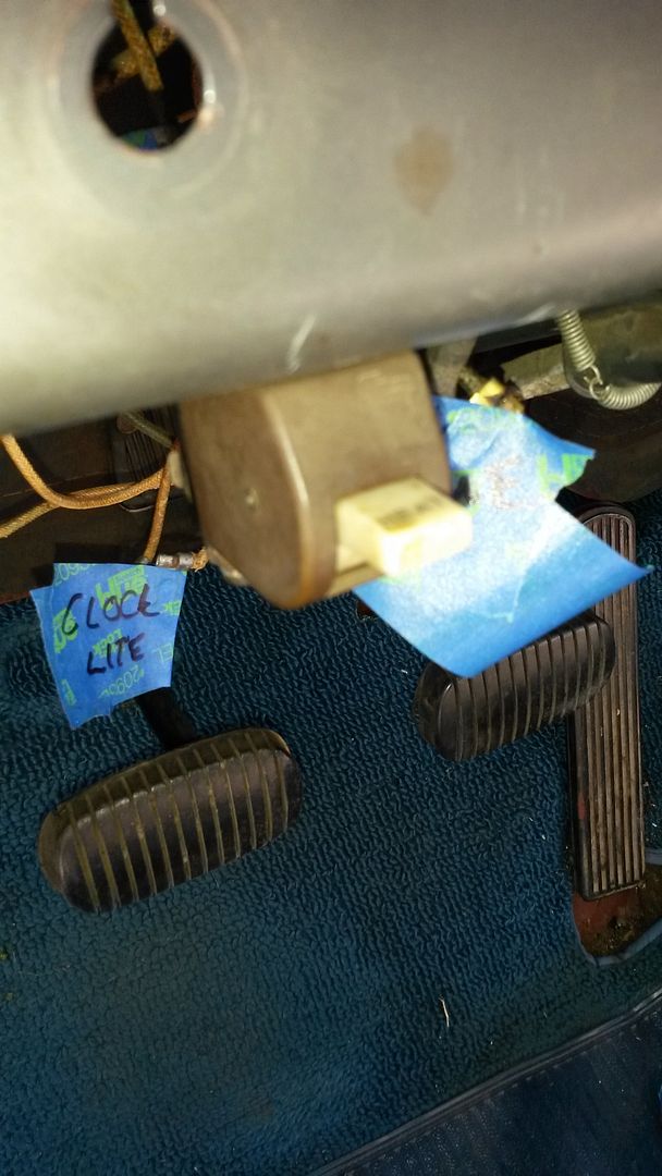

My '51 has the recirculating heater - the one with the fan switch marked "heat" below the headlight knob, no knobs on the dash. The switch has three or four positions, but only one of them is working. I'm assuming one of the positions is "off" but I don't know which one it is. I was fooling with the headlight switch the other night, and there was quite a bit of heat coming from the back of the blower switch (burned a finger on it). No instructions for this heater in the car paperwork. Can someone tell me what the switch positions are?

I have the same sw,on my 54 chevy. ( its red in color) all the way up is the off postion, next click down is high speed, here the resistor may be little warm ,next click down be mid.speed, resistor be hotter.. all way down is slowest speed here the resistor will be hot..but you need to see if it runs ok at the run position ,if not motor may be bad or the sw may be.

Lousy picture...

I have that same switch on my '50. It seems like both the top and bottom positions are off, and the two middle positions run the fan at two different speeds.
