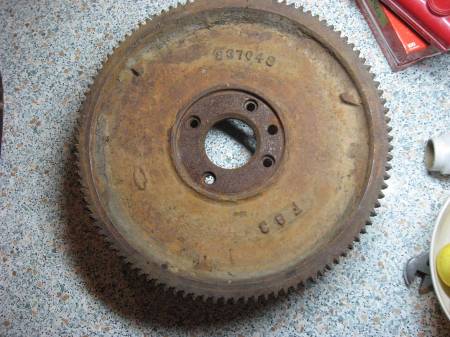

pictures of 1933 flywheel and ring gear position posted in Members pictures forum .
https://vccachat.org/ubbthreads.php/galleries/348512/1933_flywheel_and_ring_gear#comments
JACK
Great photos Jack. The photos should help Don to determine if he does have an incorrect flywheel.

The problem is solved. My car has the wrong flywheel. Dose anyone out there have one?
Here is the correct one.

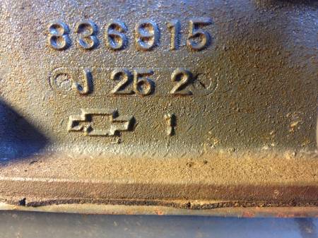

Engine casting Number for my 33

here is the engine casting #836915, J 25 2, Chevy symbol 1
Your engine is an extremely early 1933 and it was cast on October 25, 1932.
Now that you have determined that the flywheel is incorrect it would be good to check the clutch, flywheel housing, release lever,and other components to be sure ALL the mating items are correct. I would even check the transmission. Perhaps someone adapted a later trans and other items may have been changed. If that's the case you will need to decide whether to find original 33 items or perhaps even get a starter that is compatible with the components you have now.

How do I know if the current ring gear is the right count for the 10 tooth starter gear?
Since Jack has the correct 1933 flywheel that is featured in the photo that he posted, have him count the number of teeth on the ring gear and then you will know how many teeth are required.
Joined: Jul 2005
Posts: 3,192
Joined: Jul 2005
Posts: 3,192
Hey that's a bit hard , I get lost after 10 fingers and 10 toes.
The original ring gear on my 1933 flywheel has 104 teeth. It also has a lead in chamfer on the forward side to help the starter pinion engage.
JACK
The ring gear on the 1929-32 flywheel also has 104 teeth with a chamfer on the front of each tooth.
There are several differences in the flywheels 1929-1933. Width of the ring gear and mounting for the pressure plate are the two major ones. The '32-'33 bolt to the three armed pressure plate. Earlier pressure plates have 4 arms.
