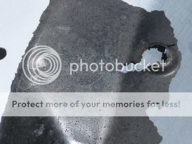

The guy doing the body work on my 41 has a 1940 Master Deluxe. It has been in the family for about 50 years and is unrestored. He found the material shown in the following pictures on the inner fenders, frame, and body and is wondering if GM or its dealers might have used any undercoating on their cars back in the 40's?
Does anyone remember when undercoating became a dealership option or a popular way to control rust. I seem to remember Ziebart being popular in the late 60's and 70's? There web site says they have been around since 1959.
Thanks, Mike
P.S. I do remember that the factory sprayed an asphalt type material inside my doors and over the interior wheel well area as a sound deadener, but I assume not for rustproofing!

man Mike that's some nasty looking stuff...Would hate to get any of that on my parts underneath
After WWII undercoating the car was very poplar and profitable for dealers. The material was not available from Chevrolet until 1949. It was considered a "service accessory" accessory # 986359 and sold in 55 Gal. drums. It was sprayed on. Prior to WWII Chevrolet did sell an "under fender" sound deadner material that could be brushed on.
If the pictured material , which has the texture of spray on material, probably was done to the 1940 some time after WWII.

I have that same type material under my 52.
I have been scraping large sheets of it off with a small putty knife. Where I am going to have problems is around the brake lines, fuel lines, and small areas where it built up. I have to admit though that the panels under it are still very clean, the paint still shines.
I have a feeling that is because my car originated in California and was never driven in salt.
