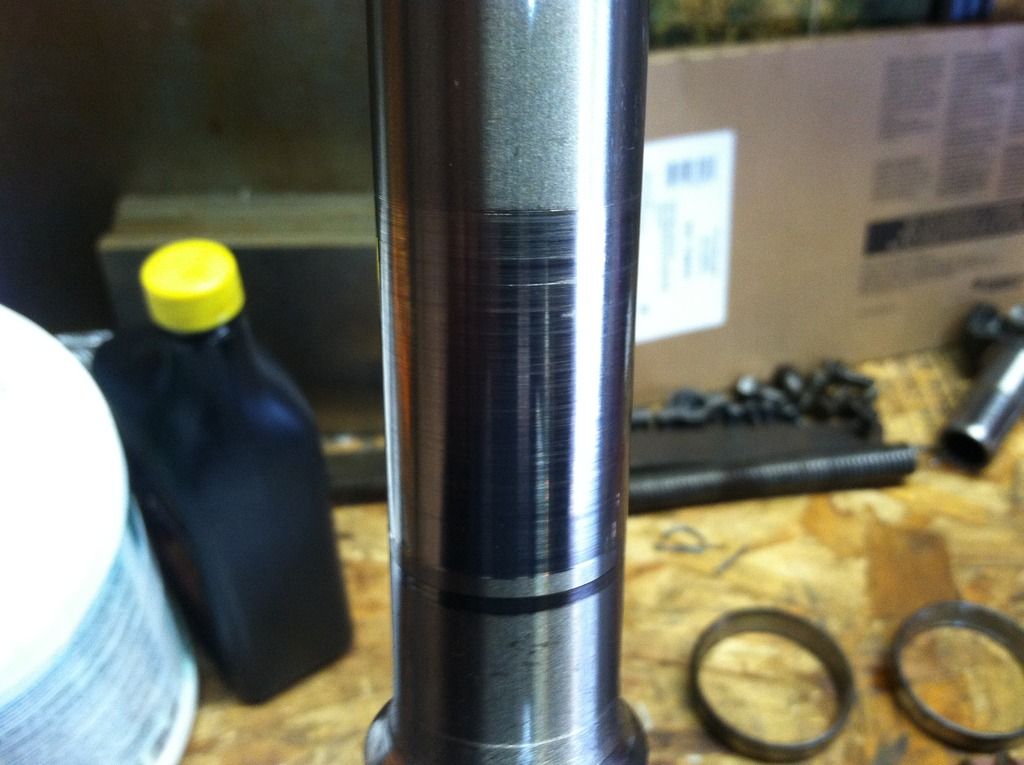

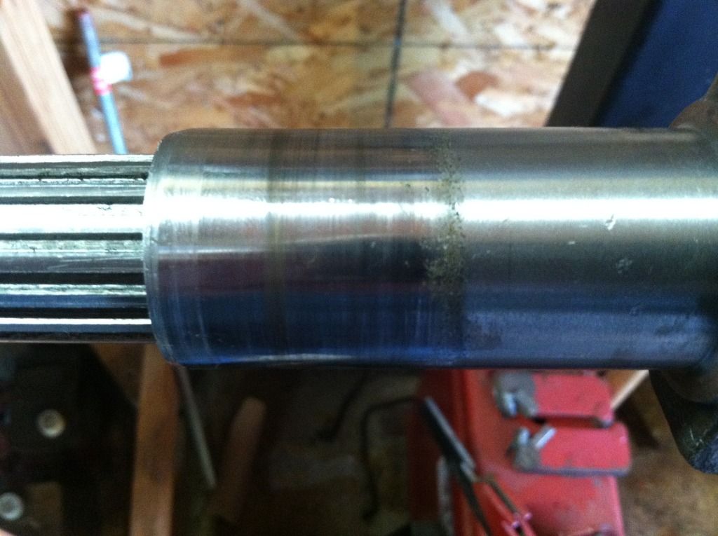

OK, so got the axles out, differential and carrier out, knocked the drive shaft out of the torque tube with no problems. Figured I could use a 6 foot long piece of pipe, go in from the housing end, and knock both bushings out the front of the torque tube. WRONG! That rear bushing will not budge! I'm underneath there wailing on the thing with a sledge hammer and it will not budge. So now I am looking at my drive shaft and figure I may as well leave the old rear bushing in there, and go with an oakie style bushing due to the wear on the drive shaft. http://i1168.photobucket.com/albums/r488/Boltergiest/driveshaft%20002_zps9o2gchwh.jpg I will bring a sawzall home from work and cut the old front bushing to hopefully ease its removal. Also some wear on the U joint yoke, will probably replace that too. http://i1168.photobucket.com/albums/r488/Boltergiest/driveshaft%20003_zpsfkoetmr0.jpg

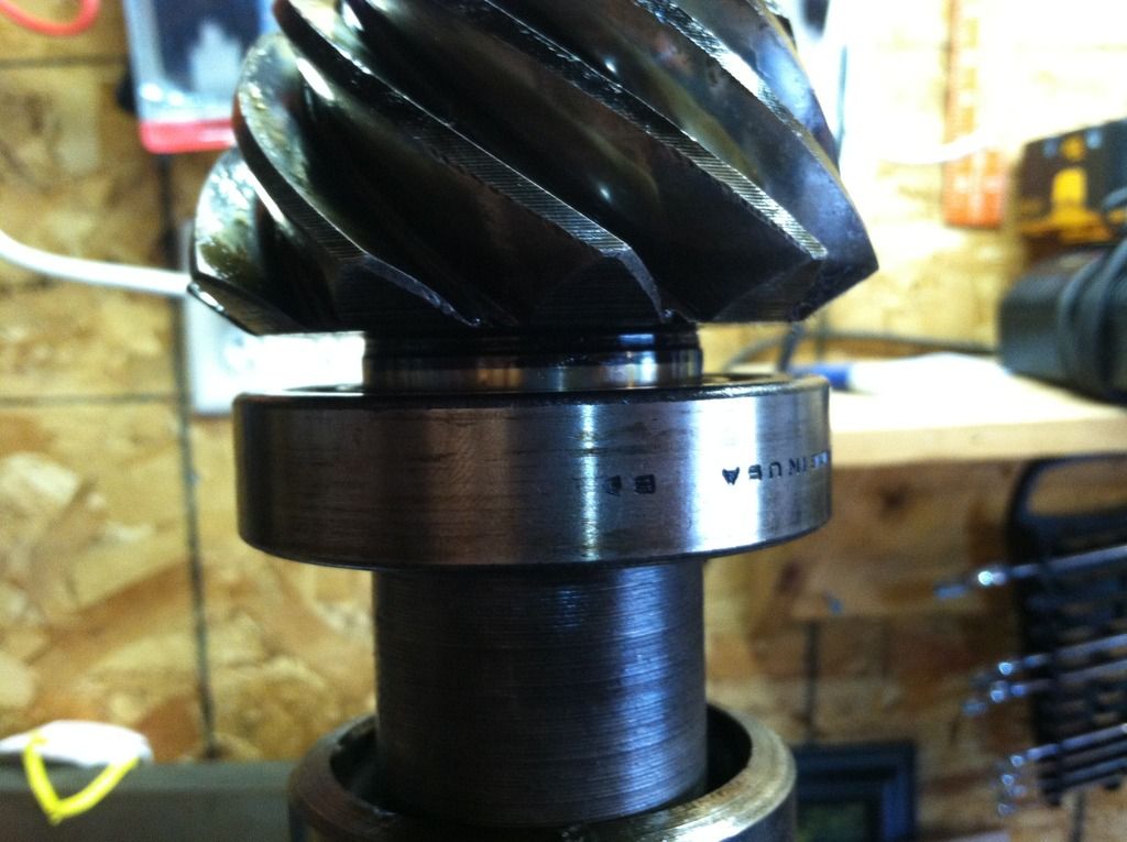

Does anyone know where I can get the tool that goes in between the pinion gear and bearing when re-assembling? Goes here. http://i1168.photobucket.com/albums/r488/Boltergiest/driveshaft%20001_zpsccfg1t2b.jpg. Also found a bad side bearing on the carrier. These appear to be barrel shaped bearings, does anyone know of a tapered roller bearing replacement?. Thanks in advance for your help

Well, that's not good news Gene! Thank you for the reply, though. I just found a Kent-Moore J-4258 bushing puller on ebay. I will try using that with some heat, and see what happens

If you use heat, go fast. If the bushing picks up the heat it will grow more than steel. The dry ice is the better idea.

Did you find a pinion gear spacing tool. I have one I was going to list on eBay someday.

I have a home made one in the works, however, depending on the price, I may be interested. PM me

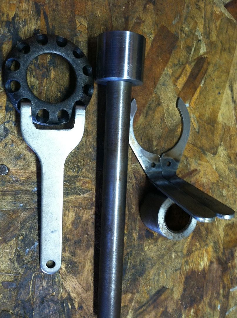

The Kent-Moore bushing remover tool I scored on ebay, worked like a charm. The rear bushing pulled with no heating, no fuss. I will have to do a little modification per this service bulletin to finish pulling the front bushing. http://chevy.oldcarmanualproject.com/bulletins/51csn0503.html
There is nothing like having the correct tool for the job.

Three tools that were in my tool box, with a little modification, now re-purposed for chevy drive line use
http://i1168.photobucket.com/albums/r488/Boltergiest/tools%20002_zpseu60iiva.jpg
