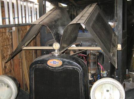

Check out a homemade hood holder. Cost = $0.
https://vccachat.org/ubbthreads.php/ubb/showflat/Number/239219

Nice farmer fix ! I was thinking of some sky hooks. Yours would be easier to patent though. idea

That is just plain too simple.
Mike, the photo is posted in the Members photo area because I don't host my pics online. If you are a VCCA member, you can see the photos in that area.
Here is the one I'm talking about (One 1x2 with a couple of blocks of wood bolted onto the ends):

The length of the 1x2 on my hood holder is 43 inches. This dimension works for my '28, but might need to be shortened or lengthened for other cars/trucks.
The point made about the hood coming down on the fenders has me rethinking my design. I'm going to add some foam rubber where the hood hits the little block and also think about some kind of latch to hook onto the hood handle for extra safety.
