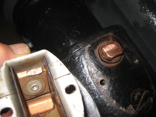

I'm trying to track down a weak cranking problem that happens mainly when the engine is hot. It gives a "grunt" but won't spin the engine and simply sounds like a weak battery BUT it's new and just load tested, starter was in the shop twice and tests fine although the switch wasn't inspected. Would anyone here see a problem with these copper switch contacts ? The two surfaces don't line up perfectly but maybe they aren't supposed to. Maybe the voltage isn't transferring adequately ? I'm looking for any weak links in the starting circuit.
I always attempt to start it with spark retarded. It' turns over okay when cold but takes 30 minutes or more of "rest" to crank again. Thank you.
[Linked Image from i109.photobucket.com]
The switch looks OK to me. I would just clean the contact surfaces and then check your cables.
