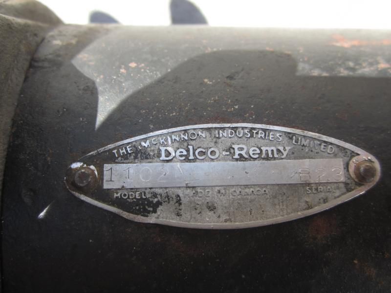

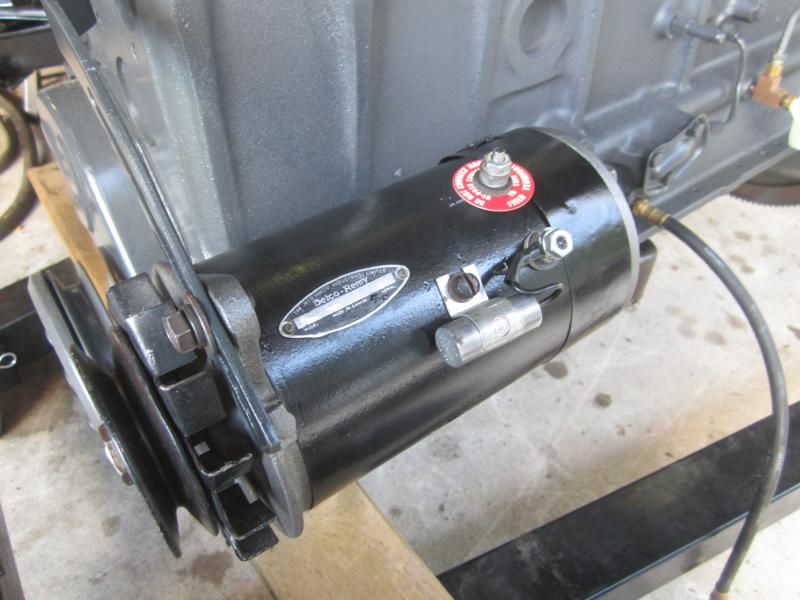

I started working on the generator today. Our Canadian built cars had many components that were built by McKinnon Industries in St. Catharines Ontario. Here is a history of McKinnon's that was written by David Hayward.

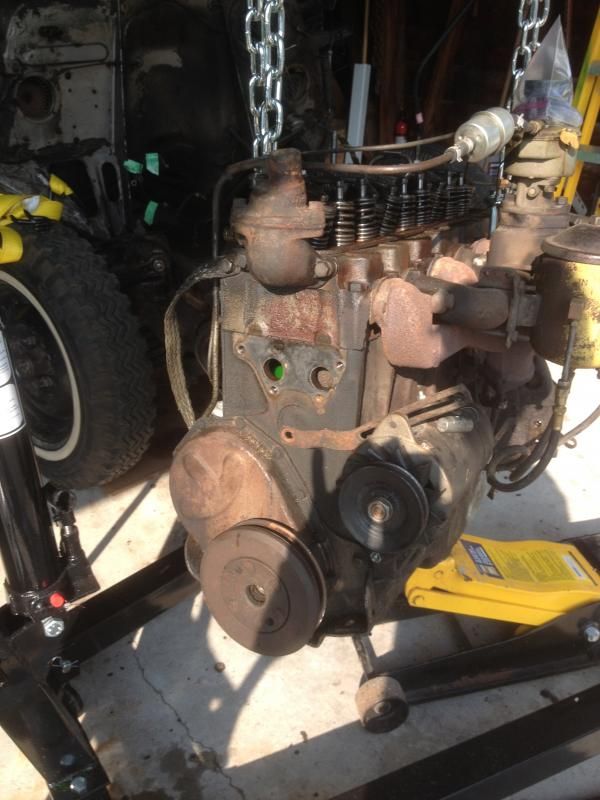

Here's the work I did today… An older pic of the generator still on the engine, because I forgot to shoot a before picture! ![[Linked Image from i150.photobucket.com]](http://i150.photobucket.com/albums/s84/brewsterg6/1951%20restoration/IMG_0594.jpg) The McKinnon/Delco Remy tag… ![[Linked Image from i150.photobucket.com]](http://i150.photobucket.com/albums/s84/brewsterg6/1951%20restoration/IMG_4728.jpg) After I washed it up, repainted the casing, end caps, and touched up the tag. Radio tag is repro from Chev's of the 40's… ![[Linked Image from i150.photobucket.com]](http://i150.photobucket.com/albums/s84/brewsterg6/1951%20restoration/IMG_4730.jpg) ![[Linked Image from i150.photobucket.com]](http://i150.photobucket.com/albums/s84/brewsterg6/1951%20restoration/IMG_4732.jpg)

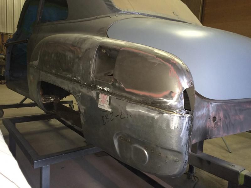

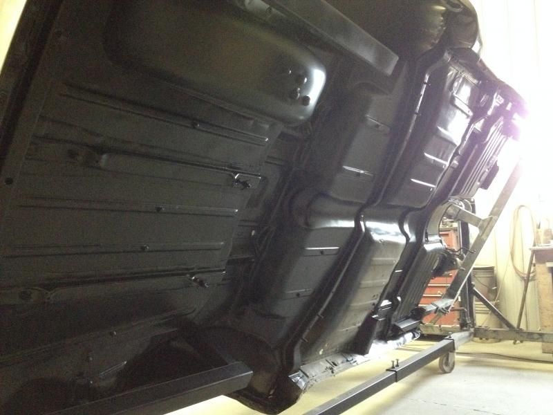

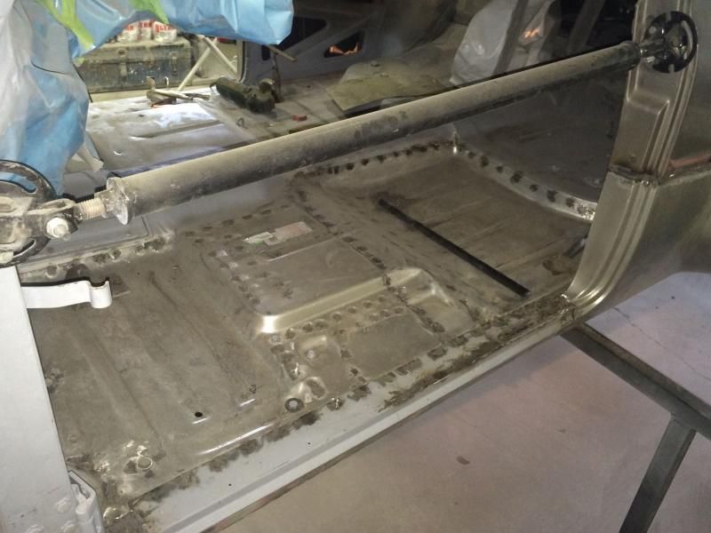

It was a Good News/Bad News sort of day today. Kerry had the sandblaster over to do the floor last week and uncovered some stuff, so I went over to look at it today. The undercoating was on the car so thick that they ended up having to take the torch and scrapers to it. It came off fairly clean, revealing some really nicely preserved areas, and some more hidden rust. The spot behind the drivers seat is swiss cheesed on the whole floor, as is the drivers side front floor. The passenger side is okay except for around the hind bolt hole for the seat. The good patch pieces from the '52 parts car are not big enough to cover all of the floor panels, but will fix the seat bolt hole. The other part that is rough are the outer rockers. A repair was done years ago, but the metal was not straight, and it was straightened out with a quarter inch of filler. No wonder the doors wouldn't shut right! Over all, the rest of the floor was really nice from the tunnel out, then all around the edges and corners there is rusted edges. Under the gas tank looks like a brand new car! The floor from the rear looking forward... ![[Linked Image from i150.photobucket.com]](http://i150.photobucket.com/albums/s84/brewsterg6/1951%20restoration/IMG_0998.jpg) Rusted edge in front of the rear tire… ![[Linked Image from i150.photobucket.com]](http://i150.photobucket.com/albums/s84/brewsterg6/1951%20restoration/IMG_0996.jpg) Drivers side front floor… ![[Linked Image from i150.photobucket.com]](http://i150.photobucket.com/albums/s84/brewsterg6/1951%20restoration/IMG_0990.jpg) Also, of the six floor braces, the two middle ones are rusted out. On both rear fenders, the metal under the gravel shield is gone, and on the drivers side the metal over the skirt and behind the wheel opening is ruined. EMS makes all of these parts, so I'll be putting in an order. The front fenders off of the 1952 were sent to the dippers, and came back really nice. One of them had a small hole at the bottom, so Kerry did a patch. The wheel openings are now the exact correct shape. ![[Linked Image from i150.photobucket.com]](http://i150.photobucket.com/albums/s84/brewsterg6/1951%20restoration/IMG_1002.jpg) We'll still need to drill holes for the Deluxe trim. Finally, a quick look around Kerry's shop. These are his Dad's Model T's. He owns something like ten or twelve of them. There is also a beautiful '57 Dodge Hardtop that is currently away getting the interior done by a fellow VCCA member. ![[Linked Image from i150.photobucket.com]](http://i150.photobucket.com/albums/s84/brewsterg6/1951%20restoration/IMG_1004.jpg) ![[Linked Image from i150.photobucket.com]](http://i150.photobucket.com/albums/s84/brewsterg6/1951%20restoration/IMG_1005.jpg)

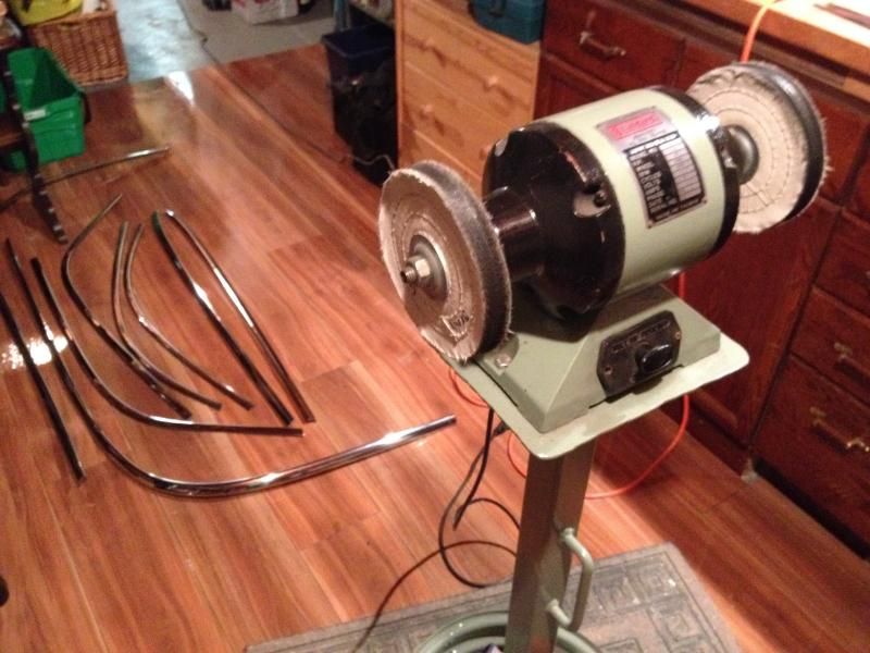

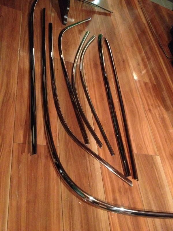

Trim is looking good. Back in the 60's, when my 3 children were born, there was no 10 weeks off. I got the day of birth off(with docked pay) and had to be damn certain I was at work the next day. Times have changed.

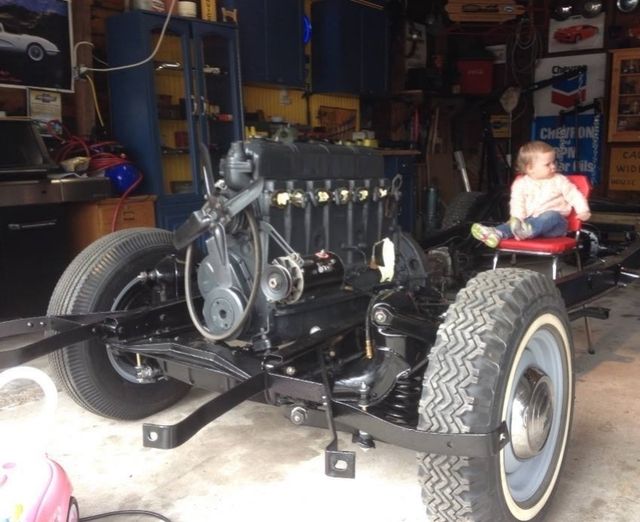

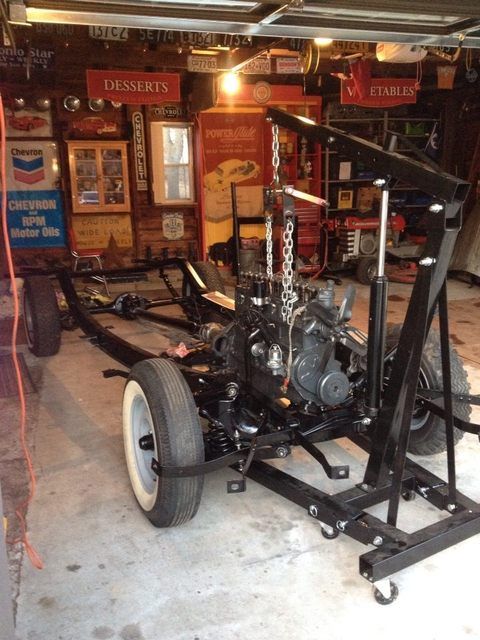

Engine is almost back in. Two more bolts to go… ![[Linked Image from i150.photobucket.com]](http://i150.photobucket.com/albums/s84/brewsterg6/1951%20restoration/10922732_10155349089360231_6220815756847059726_n.jpg)

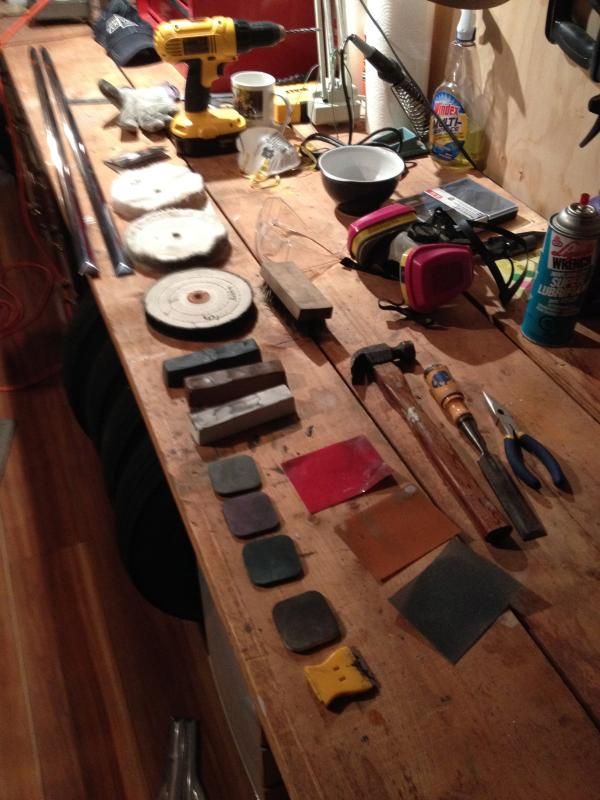

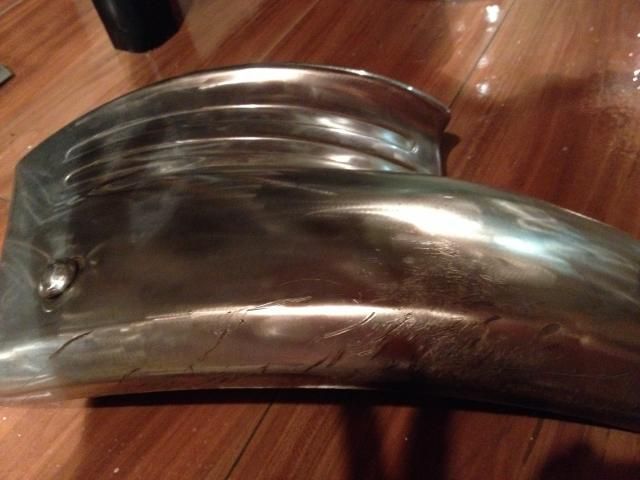

What is the sequence of grits used on the stainless. I still have to start mine next winter? Thanks

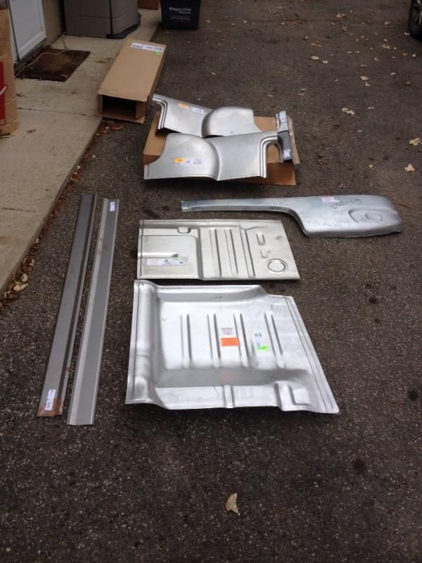

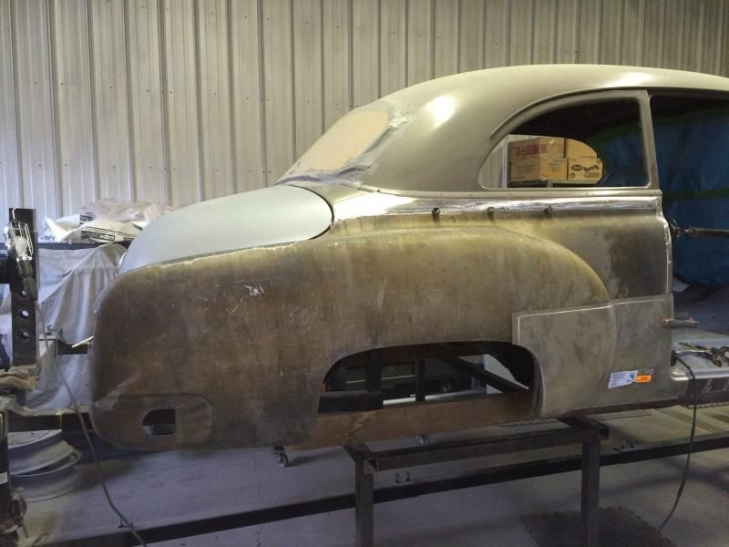

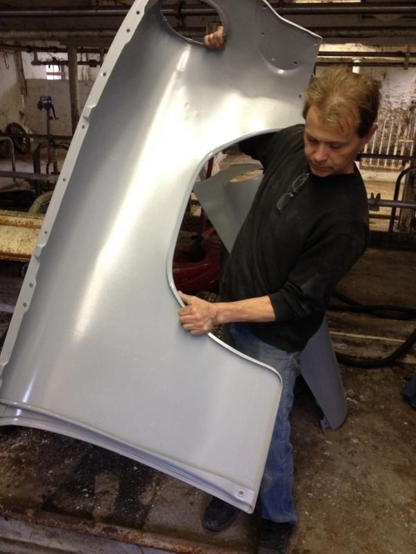

Great job you are doing. If i may ask,where did you get your body panels and was the fit good?

Does your body man have an estimated time of completion ?

What is the sequence of grits used on the stainless. I still have to start mine next winter? Thanks I used the sanding pads from 3600, 4000, 6000, and 9600, then switch to the bars. They don't have grits on them. All I know is that you use black, brown, white and maybe green if it's needed. I'm ready to start the white now.
pete Body panels were EMS from Chev's of the 40's. As far as I know they worked out Okay, but I haven't talked to Kerry about that yet. He said the floor panels worked well...

Does your body man have an estimated time of completion ? Not sure yet, Bob. The frame is going to him next week and it should go together fairly quickly after that. In the meantime, I did have my Chief Test Pilot take the chassis for a test drive… ![[Linked Image from i150.photobucket.com]](http://i150.photobucket.com/albums/s84/brewsterg6/1951%20restoration/11070836_10155384152295231_8774037764483977529_n.jpg)
pete Body panels were EMS from Chev's of the 40's. As far as I know they worked out Okay, but I haven't talked to Kerry about that yet. He said the floor panels worked well... Would it not have been more cost effective for you, to have ordered your EMS panels directly through EMS ?

They don't sell them direct… they have distributors, and Chevs of the forties is one of them. I think the price is regulated to be the same at all of the distributors.

They don't sell them direct… they have distributors, and Chevs of the forties is one of them. I think the price is regulated to be the same at all of the distributors. OK, I was under the impression that they sold direct, as well. I believe EMS either bought out another panel company from the same area in Cleveland, Ohio, where I grew up ... or changed their name, along the way. I recall the other company name of "Made Rite" panels .... bought rockers from Made Rite for my '56 Chevy many years ago.

I saw a video on chevy talk about EMS and they do sell direct and gave a web site and phone number.
pete I thought that was the situation, with EMS.

I have found that many of the larger vendors purchase in quantities large enough that they can then sell for less than some manufacturers do direct. Purchasing from less sources also reduces freight cost and in some cases can qualify for free freight.
