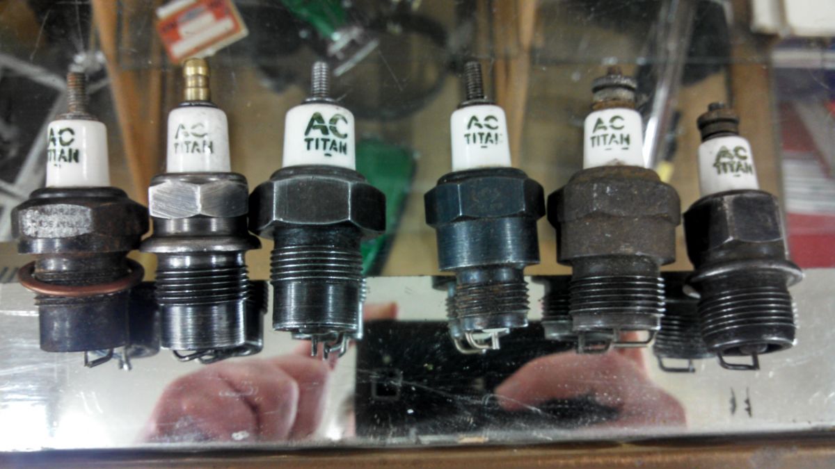

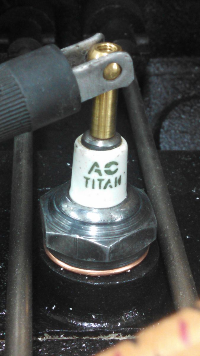

So this picture shows what Ardie had installed in the V8 display engine. Notice that the ball end or tip, not sure what it really is called, is very long. You have some which are shorter. In my box if stuff I also have some which are short also. Anyone know what is really correct?

Now in the next picture is a sample of all the AC Titan's which Ardie had collected, I went through all of them and picked out one of every type or style. The left 3 are all 7/8" long or reach.
So what is the difference between all of these?

The only advertised terminal(nut) for Chevrolet's is the short ball nut. There is advertised a long terminal similar to the one shown on the display engine, but it has a flared out bottom adjacent to the spark plug is for a 4 cylinder Willy Knight. The one shown looks to be a new manufacture , perhaps by Ardie to keep the plug wires clear of the push rods.It may be unique to the D V8 but I don't know, what is shown in the workshop manual ? or on the V8 that was in the ford museum?. The spark lead end is the same as Chevrolet used on 4 cylinder 490's.
The AC spark plug on the left is a AC titan long, 78LT
2nd from left SAELT = SAE Long
3rd 78LT later version seen in 1925 advertisement
4th possibly MTCP Metric titan Carbon proof "possibly"
5th 78RT ( regular thread length)
6th SAET (regular length with reduced nut size "SAE" size)
The fancy logo on the spark plug list is the crossed over "AC" as seen on the AC1 spark plug seen above.
The only spark plugs listed in advertising for Chevrolet is the AC titan long 7/8 - 7/8 (ACTL 7/8- 7/8 in),and the AC cico (ACCL 7/8-7/8 in) for the earlier 490's
The CICO stands for Champion Ignition Company .
The Cico and versions of the Titan were the only types of spark plug produced by Champion Ignition company in 1915-1916 (at least)
There was also extra long , extra long body, and an in between
LONG and REGULAR , 78DT which looks similar to the regular , but just with slightly longer threads. Plus other specials for Ford Dodge etc etc,,
Heat ranges? most drivers and mechanics wouldn't have known back then and would have fitted the manufacturers recommendations only.( or what ever they had in the shop to sell to the customer and make a sale, as long as it screwed into the head and the car started,)
