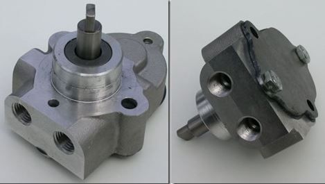

As a matter of interest, does somebody do reproduction pumps?
Here is a photo of the reproduction pump that I purchased recently.
[Linked Image from i1264.photobucket.com]
Roger
Roger
Hi Roger,
Nice pump, where can I find out more? I notice it doesn't have the relief valve I have been speaking about.
Regards
Al

Hi Al,
Look up eBay listing, 261717344253.
Here are some details,
1924-25 Oil Pump for Chevrolet cars and trucks.
The oil pump is new reproduction.
The casing is made of Aluminum with brass gears.
The machining has been done on a CNC machine.
I have new Generator End plates and distributor housing.
Call with any questions 314-293-1991.
Roger
