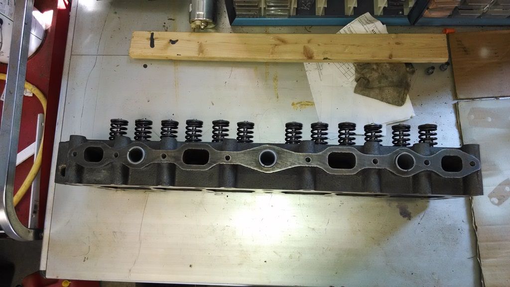

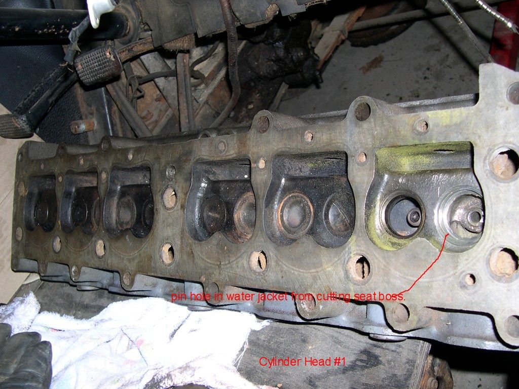

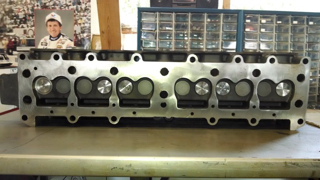

Here are some photos of before and after the machine shop reconditioned the head.
It looks as if they used larger intake valves....no problem in its self.
