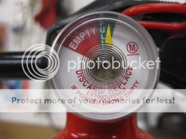

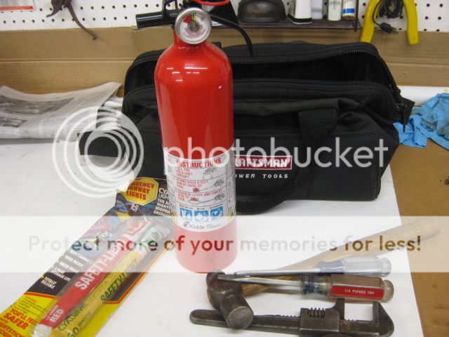

Here is what I carry in my 41. It has been there for over 10 years and has not been refilled. Notice the extinguisher is not refillable. All my extinguishers are ABC Kidde dry chemical extinguishers.

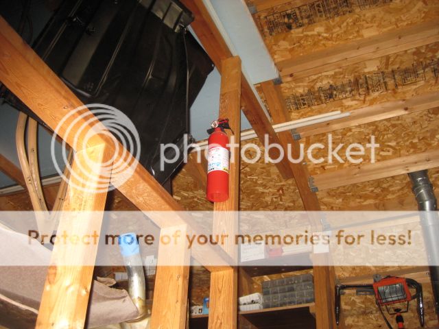

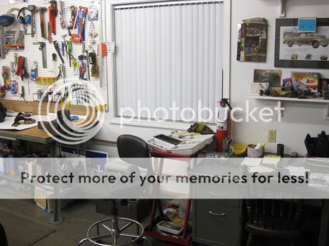

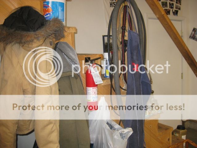

The following extinguishers are around my garage. They are rechargeable and I have had them recharged once in 2008. I have had no problem with them needing yearly recharging. I have a very large one on my desk, one hanging by my stairs, and another at the top of the stairs. I'm wondering if the one at the top of the stairs should be moved to the middle of my second floor, which only has the stairway exit and windows at each end?
