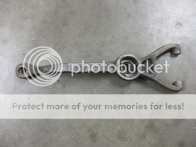

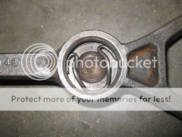

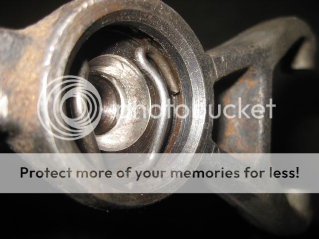

Can I get some help on where the "throwout arm to ball stud clip" goes.
As of right now it's not installed, I can't figure out where it goes.

Hi Fleetboy,
Just make sure the bow in the clip is facing you so it will slip easily over the throw out arm ball (see third picture). Put a covering of multipurpose grease on the ball, and in the throw out arm socket, when you fit it in place. I use a needle point pliers to collapse the clip, a little, to help get it in place.
Aligning the arm with the ball takes a little finagling as does pressing on the arm to the ball with the spring in place. It kind of just pops on and needs to be pried off to be removed. Your manual is a good place to verify what you should be doing and aware of, and a little patience is helpful.
