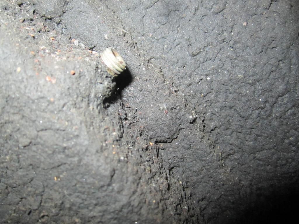

Anyway, while replacing the gasket on the timing gear cover, I had to stop and analyze the cam gear, which is documented as made of "fiber"....looks like it is made of a resin and has the name "Formica" on the bottom...does that mean Formica made them for GM?
[Linked Image from green427.smugmug.com]

I found this on the engine from my '37 "white car" after the buyer brought back the engine/trans because he didn't need them.
I realize this is not a true fix or original to the engine but thought it was a neat set-up. The pic below shows a fitting brazed to the timing cover to supply oil to the timing gears. It was plumbed from the oil distributor by "T"ing into the supply line for the valve train. As you can see from the grunge on the timing cover it had been installed a long time ago.

Took the transmission out. Got some bolts and cut the heads off to make guide pins in the top holes.
When I took the front bearing retainer off, I expected to find a large nut that needs to be unscrewed off, but this is exactly what I found:
Looks like the last person to service the transmission did not put the retainer nut on???? I have a spare 'donor' transmission that I will rebuild as well, hopefully there is one in that.
Front bearing came out fairly easily, pulled out the main shaft.
Bearings and all gears appear to be in decent shape.
