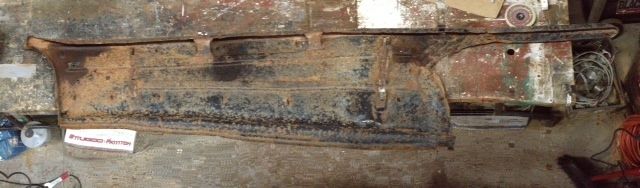

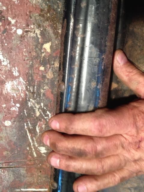

I'm working on the running boards for my 36. Where the running board goes under the body there little rivets that have what look like treads still attached. Is there some sort of welting that goes on these rivets?? The boards were already off when I bought the car.

Between the running boards and the rocker panels they used a special rubber design that fills any gaps, its called ANTI SQUEEK. lYNN STEELE IN nc MAKES IT and iandireproductions.com in California carry it as does, The Filling Station.
mike lynch............. Agrin
www.steelerubber.com
makes this which is what you need..........." Misc chassis & body rubber parts cont. 1933---1939 anti-sqeak runningboard to body. Replaces #350645 . Bulb seal types replacing composite sold and sponge rubber original. All models including sedan delivery 12 foot strip # 60-0054-73 $43.20 fo0r 12 foot.
