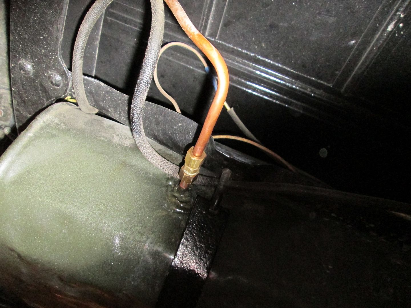

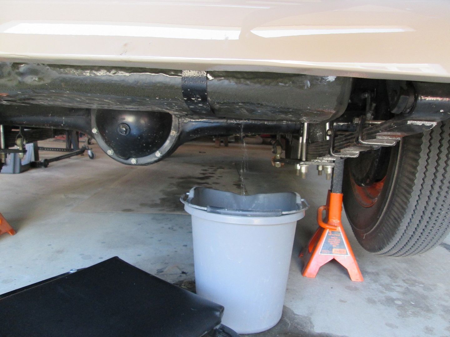

I traced a pervasive gas smell that had been bugging me to a leak at the point where the pickup tube exits the front of the tank on my '34 Master. At first I suspected the fitting where the fuel line connects, but it appears to come from the tank wall, about 1 1/2 inched behind the fitting. So I drained the upper half.
Then I looked in the FS catalogue for a replacement. The only thing in there for a '34 Master is a $750 stainless unit. Looks like I'll have to remove it and try to fix the leak. Is that tube just soldered in a sleeve at the tank wall? The stub is about 1 1/2 inches long. I can't see for the coating all over that area.

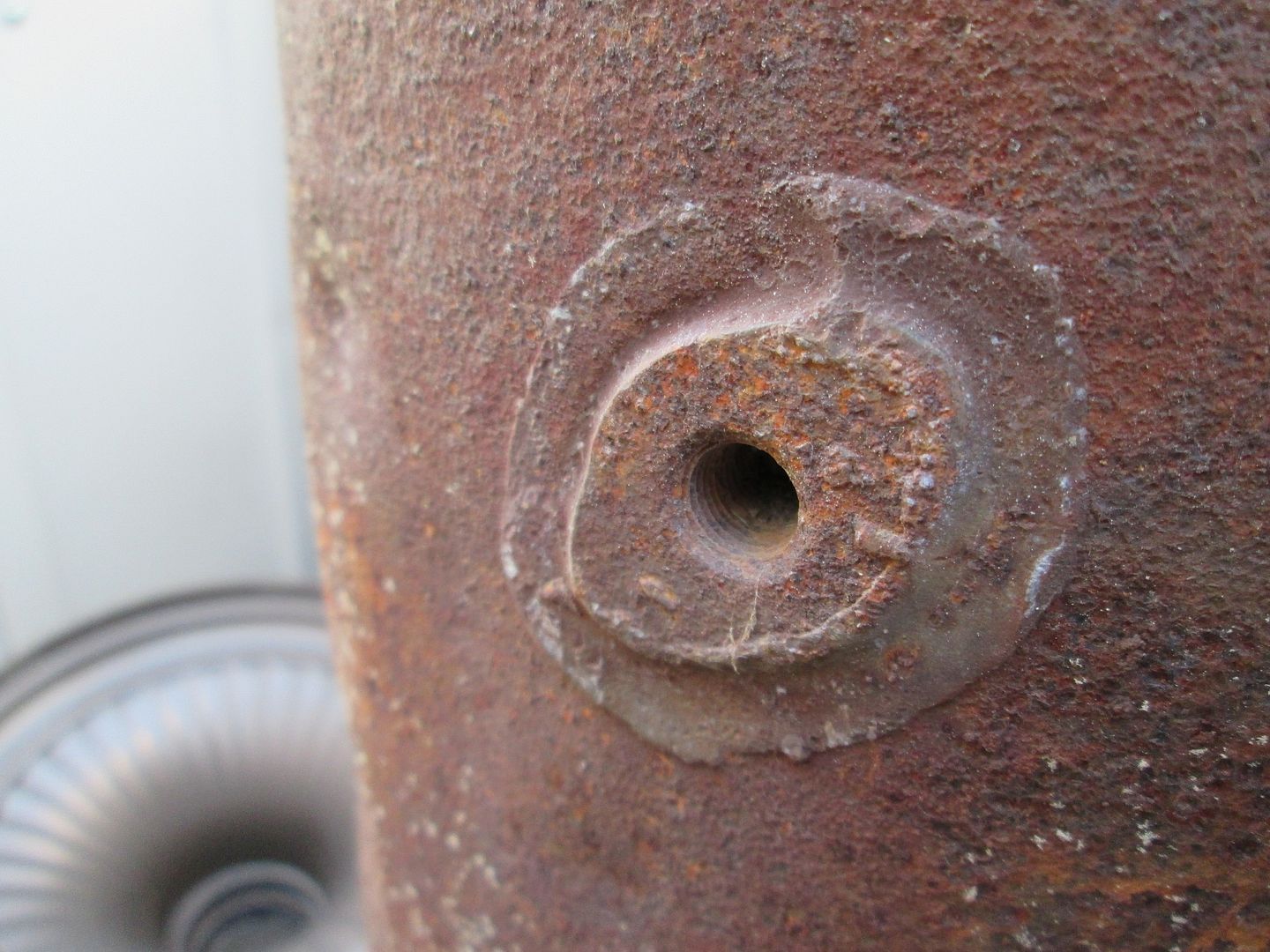

I just remembered the old tank behind the shed. Looks like there is a threaded plug soldered to the wall. I assume the stub is a threaded steel tubing that screws into that.
I crawled under the car for another look, and now that I know what I'm looking for, it looks like that plug is there too.
