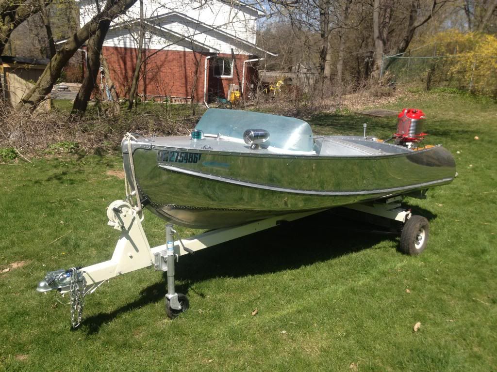

I bought the car with three things in mind. Drive inn movies, cruising around when its too windy to go boating and to pull my polished aluminium boat to antique outboard motor club meets. Antique outboards and Feather Craft boats are my first love. I like to collect and restore both.
Here is my car and a couple photos of my 1957 Feather Craft Ranger III and 1955 Mercury MK55 outboard.
