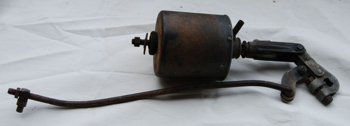

I will post some pictures which should aid those who are trying to help me. I had looked at the information at the site you suggested but had not noticed the replacement shift rod which is now available. Thanks for that piece of my puzzle.

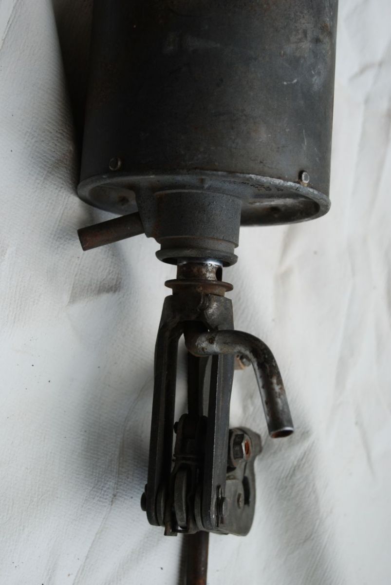

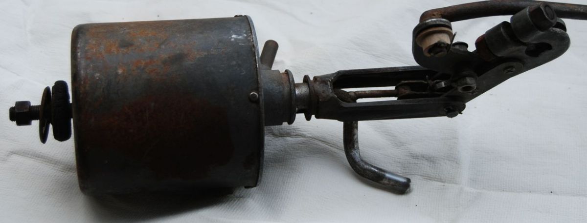

Here is what I found in the trunk. The unit is very stiff but appears to be all there I think . Will later shoot pics of what is currently installed.
