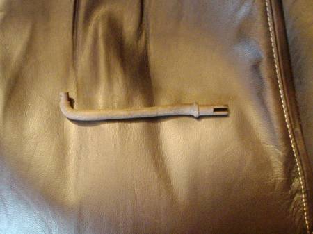

My 39 is a 4dr sedan...I was getting faults reading too..thought maybe it was the wiring..I have not tried to see if things are ok yet..I'm also doing brakes at the same time. Hey you would have a right side Extension strut laying around. ![[Linked Image from vccachat.org]](https://vccachat.org/gallery/48/medium/3025.jpg) This is a picture of a left side...
