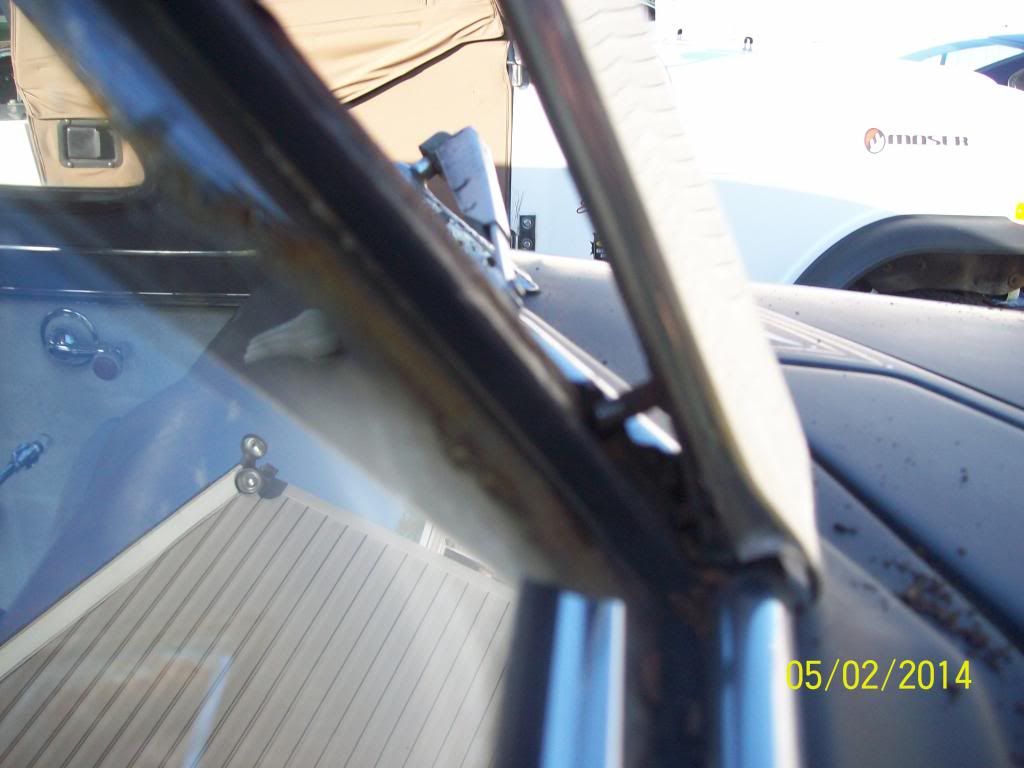

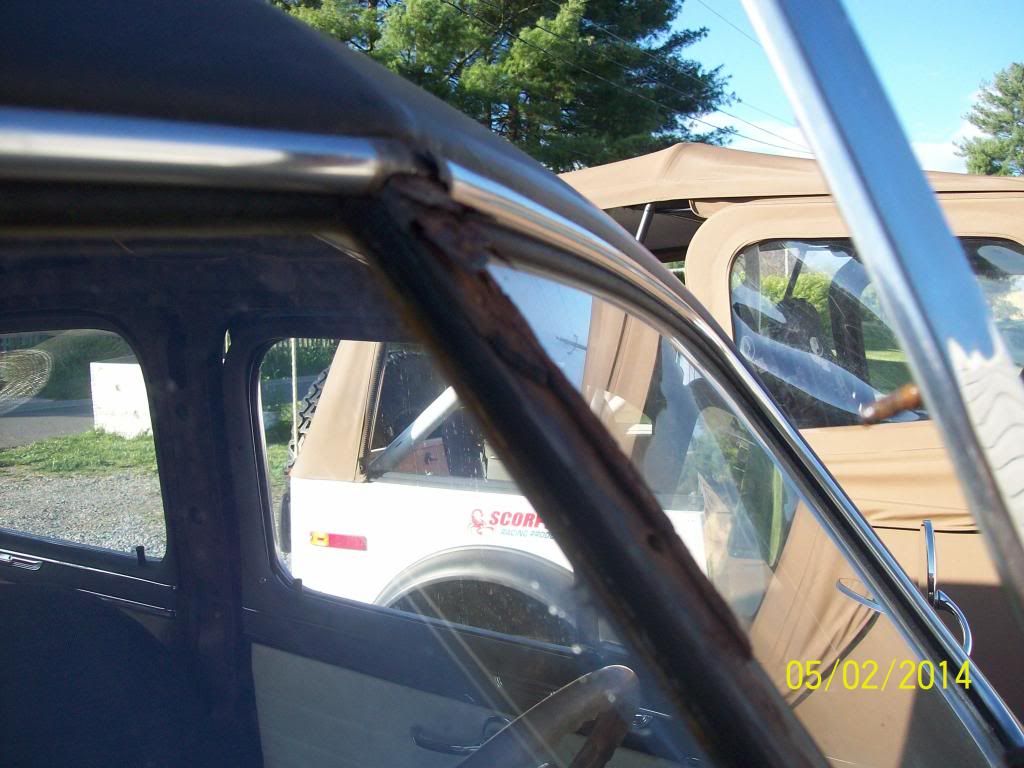

well I'm in the middle of center stainless removal, But it broke on the top, How does the bottom come out of the rubber/trim here are some pixs.
[Linked Image from i1168.photobucket.com]
can the middle trim be taken off without removing the trim around windshield.

That center piece is welded in. It is just rusted out as I mentioned in my post above. You will have to remove the windshield, cut the rusted piece out at the roof line and cowl and weld in a new one. You can get a new divider section from Chev's of the 40"s, part #4114574A.
Rock it side to side and pull up and out.
How did you remove the heads of the screws?
It is hard to tell from the pictures how bad it is right now.
Go ahead and remove the glass and the inside weather strip. It is going to be very hard after all these years. It is pretty much all "fused" together. Than we'll know a little more. Sorry, but this is common.
