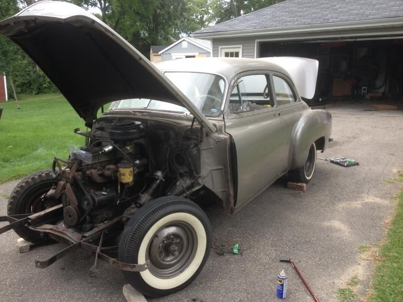

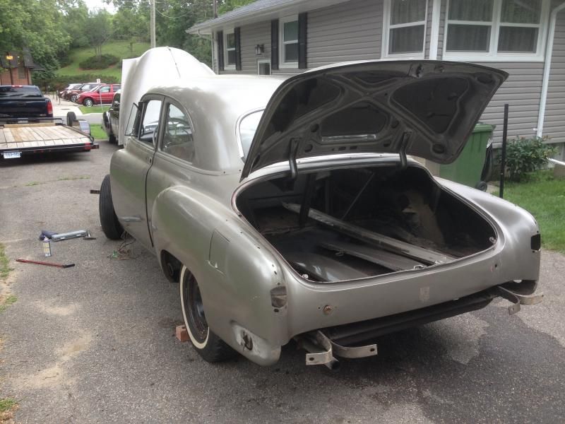

Today was the big day! I started by hauling out all of the parts from the '52 parts car, and picking what I thought Kerry would need for doing the body work, and what would fit in the truck. I'll have to take another trip to get the rear fenders there, as my load was pretty full. The front fenders are much nicer than what is on the car. Beside each other, you can really see where work was done on the original ones incorrectly. The wheel lips are the wrong shape, and there is a lot of Bondo. I took it all down to Kerry… about a two hour drive. We spent a couple hours unloading it, going over all of the parts, and discussing strategy. ![[Linked Image from i150.photobucket.com]](http://i150.photobucket.com/albums/s84/brewsterg6/1951%20restoration/IMG_0635.jpg) ![[Linked Image from i150.photobucket.com]](http://i150.photobucket.com/albums/s84/brewsterg6/1951%20restoration/IMG_0636.jpg)
Posts: 7,472 Likes: 26
Posts: 7,472 Likes: 26 |
That sheet metal looks pretty good! Are you sure you cut up the right car?

The lips of the fenders have all been replaced, and rebuilt. The fronts are the wrong shape, and the stone shields don't line up with the edges right. On the other side of the fender you can see where the patch was welded over the original fender, with the rusty edges of the original still showing on the back! The visible side was filled with Bondo. The inner fender liners are like new under the undercoating, with all of the factory black paint still on them. The upper corners where there was no undercoating have rusted away. The parts car has surface rust, but are all useable. There are pictures back on the bottom of page one.

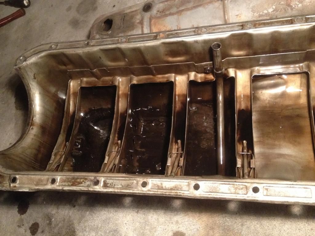

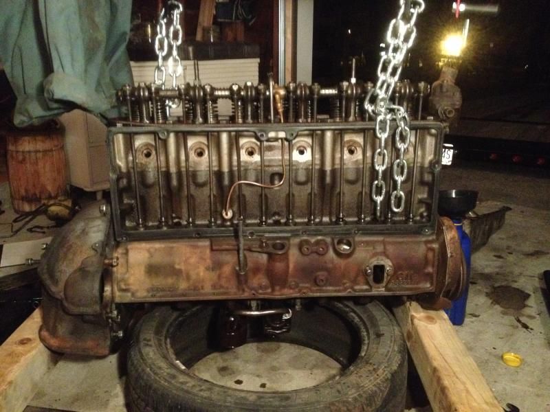

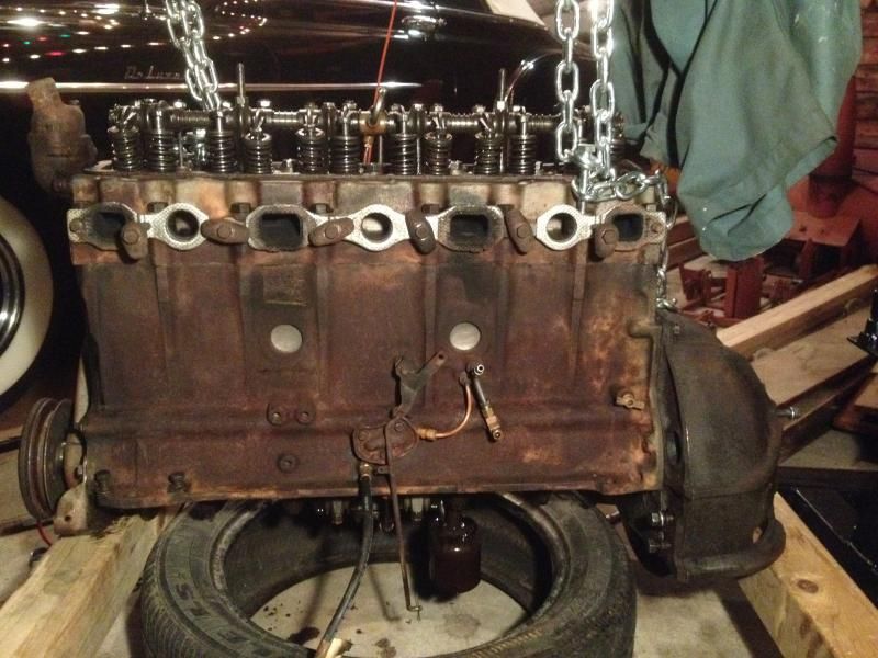

A lot has been happening this week! I've got the engine all stripped down for the replacement of the gaskets, and painting. My question is: have I gone far enough? Are all of the oil leads to the filter, and the rest of the parts left on it painted grey? My strategy for painting is going to be this: give the oil pan, side cover and valve cover a coat of paint separate from the block. Then install the gaskets and covers, then put final coats of paint on. ![[Linked Image from i150.photobucket.com]](http://i150.photobucket.com/albums/s84/brewsterg6/1951%20restoration/IMG_0659.jpg) ![[Linked Image from i150.photobucket.com]](http://i150.photobucket.com/albums/s84/brewsterg6/1951%20restoration/IMG_0661.jpg) Another thing… does this look okay? I don't think the pan has been off in years, so I'm hoping this bit of sludge isn't too much. All of the oil troughs had clean oil in them, and although dented in a few spots, the pan looks good. ![[Linked Image from i150.photobucket.com]](http://i150.photobucket.com/albums/s84/brewsterg6/1951%20restoration/IMG_0662.jpg)

Besides engine paint, are you planning an engine rebuild or a good desludging OR ....... ?

The oil filter lines are not painted. The copper line for the rocker arms is painted. That is a 1952 block as it has the bosses on the side for ataching the 1952 style motor mount brackets.(three bolt holes) The late 1951 Canadian 216 engines had the low side cover....so what is the casting number on the right side of the block?
