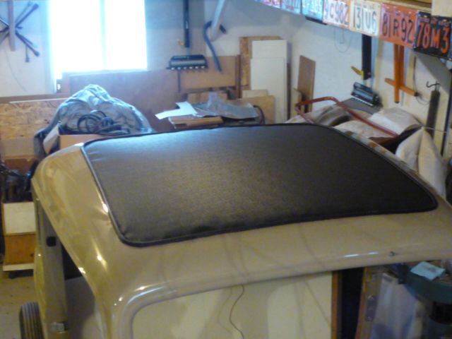

I bought the FS kit, had everything I needed except the burlap on the wood. I installed it with the Hidem provided. I had bought the aluminum strips but couldn't bring myself to bend, drill & countersink them.

It does have very good instructions. I put burlap down to support the cotton padding. In the day they also had the chicken wire that was the antenna as well. I still have the aluminum strips. Check my thread here: http://forums.aaca.org/f190/reconstruction-34-chevy-master-coupe-297983-24.html The roof insert starts in posting #591.
The original nailing strips are not available, only similarly shaped aluminum strips. They have to be bent drilled, each hole countersunk then screwed. I was simply too lazy and/or chicken.

The hardest part is the final top covering to get it nailed down in the sequence, the instructions ( from Lebaron-Bonney )say to use so that the top goes down tight & straight without puckers on the edges or the corners. Its a take your time , follow instructions and do it right operation.
I stupidly did not use their hidem on the edges. I used the aluminum vinyl top strips and bent and drilled them for screws. Not a good decision because your making all kinds of #4 holes in the cloth in order to screw it down. Each one of those holes is a potential leak.
