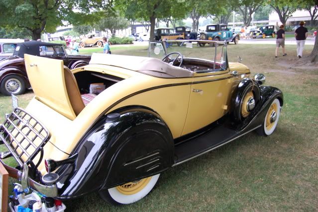

I "saved" a photo of a '32 Chevy Five Passenger Coupe - Black over Yellow - the nicely dressed unit with the Bow Tie; that inspired my question in the first place. That is why I inquired in the first place. I'm not sure if it was/is original but it sure looks good!!! Thanks for the help, EH.
'33 MASTER PARTS WANTED ~ ESPECIALLY SHEET METAL! RADIOS & "TRINKETS; TOO.
That color combination on a 1932 five-passenger coupe is not original. But, if you like that color then it is your choice.
If you were looking at a Canadian built car, it may very well be right. I'm not sure if '33 colours carried into '34...but one look at Burt Fulmore's Cabriolet sells yellow and black on me. A Canadian offering for 1934, not available in the USA...

Thanks guys for posting the info! Unknown Paint Code # on the "Bustle - Back": 1318 & Trim Code: #87. Of course these are Canadian, EH!!! So I understand, the US & Canadian Paint Codes are different - makes sense. Brewster - you sure post beautiful photos - must have something to do with the subject matter & your personal taste in cars? Guess I'll have to use a bit of creative licence & get the crayons out...............
