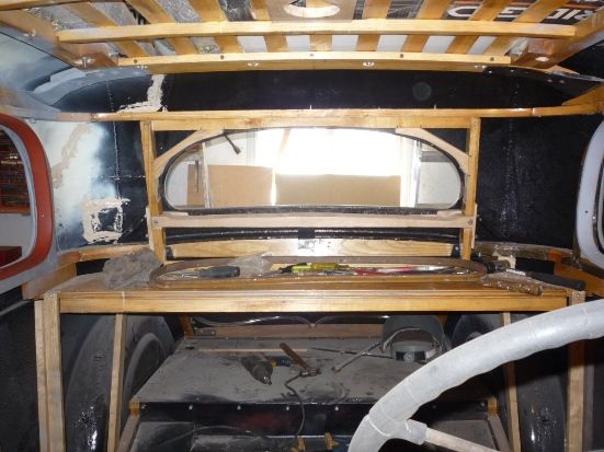

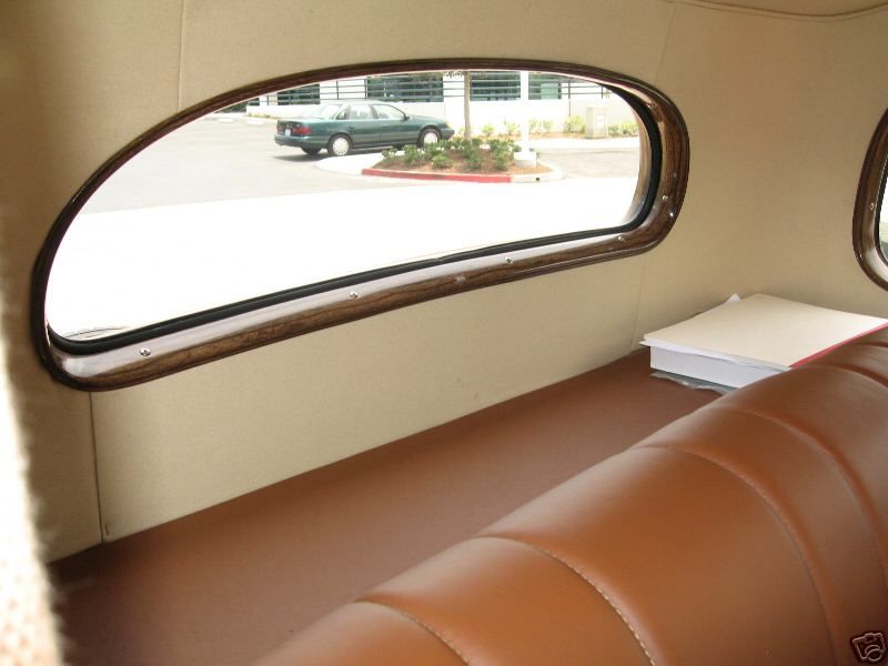

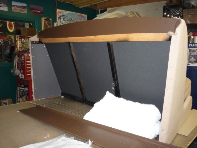

Is there any pictures on what the wood looks like behind the seat. trying to figure what pieces I am missing for panel behind the seat and deck area below rear window. Any help would be appricated. Thanks Rich, here's what my '34 Master looks like. ![[Linked Image from i1176.photobucket.com]](http://i1176.photobucket.com/albums/x324/landman2/Reargarnishmldg5.jpg) This is the seat of a '34 Master 3 window ![[Linked Image from i1176.photobucket.com]](http://i1176.photobucket.com/albums/x324/landman2/june22201224.jpg) And this is the appearance of the finished shelf ![[Linked Image from i1176.photobucket.com]](http://i1176.photobucket.com/albums/x324/landman2/ParcelShelf-1.jpg) If I'm not mistaken, there is a flap of vinyl which links the front of the shelf and the back of the seat which folds and unfolds when the seat is moved. Mine doesn't have that as I used the seat of a sedan.

One word: GORGEOUS

One word: GORGEOUS  Just so there is no confusion, only the top photo is from my car.But you are right, the third one IS gorgeous. I thought about doing that but the price of leather scared me off. Merry Christmas everyone.
